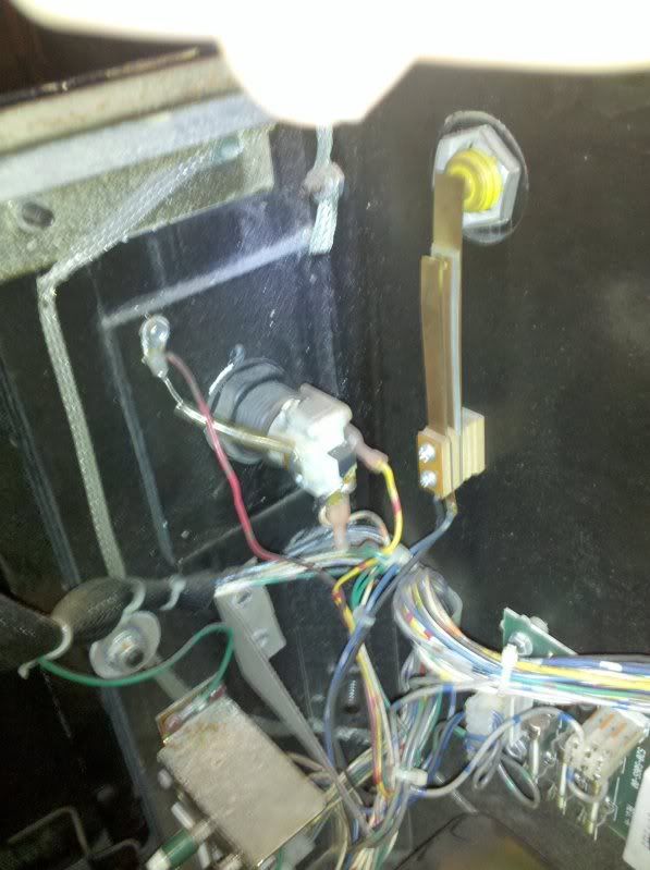

As for the start button: There is a diode that is attached to a red wire that is screwed to the ground strap and to one of the start switch lugs. Unfortunately, I don't know which lug. Can someone with a JP let me know which one? When I first turned got this running, the start button worked. Pretty sure I didn't have that diode connected then.

my JP:
there's a diode running in between that red wire/post and the post on the start switch on the right side of it....the banded side of the diode is closest to the red wire/post.
also, there's a diode running in between the back post of the switch & the bottom post closest to the front of the cabinet. the banded side of that diode is closest to the back post of the start switch.
i hope that's the info you were looking for and hope it helps.
Yep, there is a 'missing thing' on the lug for the lamp. That shouldn't effect the switch, so I wonder what has happened?
