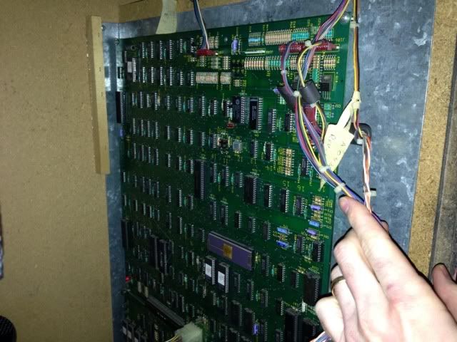

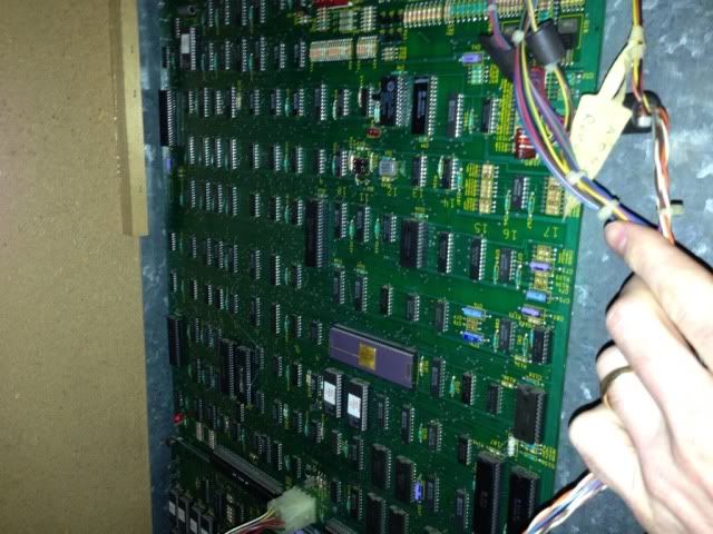

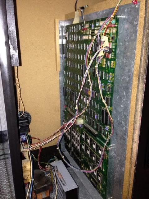

I finally got a minute to look at my game. To me, it seems like your motherboard is different from mine (sorry for the phone pics):
BTW, the only light that's on when it's running is the bottom left one, toward the back wall.

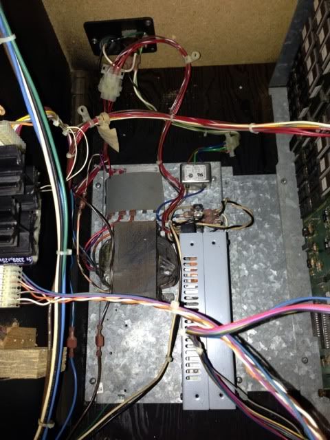

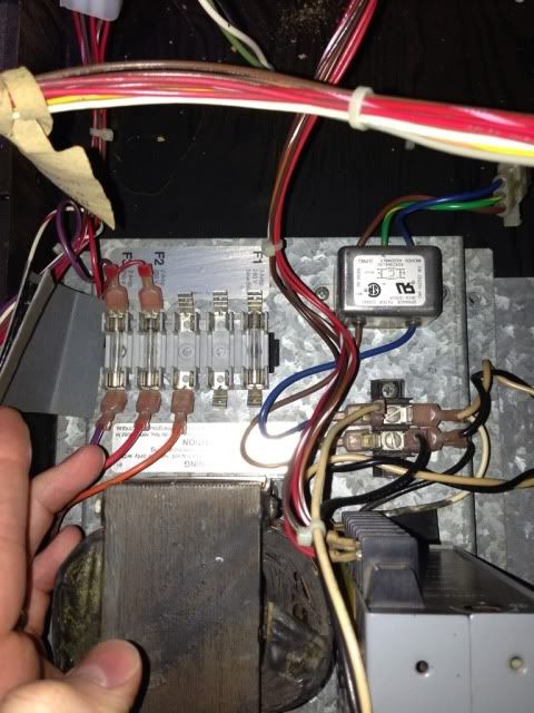

Your power supply is also different...mine's running on a switcher:
I'm really not the guy to ask how or why, but they're obviously different. I don't know if they had different revisions of the board, or what. I also don't know if the different revisions required different wiring, etc., but I doubt it. If there's anything else I can do, I'm happy to help.
