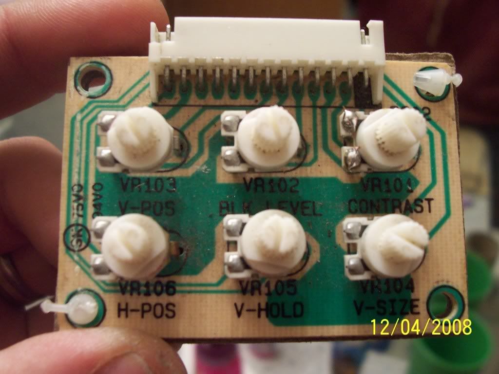

Display tuning?
Can anyone describe the flyback piece? Where is it? Anyone have photos? I am just curious as to how you tune the monitor, while you are behind it and what knobs I need to be touching.
most likely yours only has 2 pots (focus on top, and brightness on the bottom).
sweet spot for focus is somewhere in the middle usually.
use the color bar utility in the test menu to adjust your contrast (you want that at the point where none of the colors are bleeding).
it should be mounted below the control panel or inside the machine somewhere on the side if it's been moved. (it could look slightly different from the one pictured tho).
Looks like the P802! Had that one dangling out of the T2 machine i traded for MK1... I broke every friggin pot on that thing!
both of the machines i have right now have that same remote board, but my mk1 cab has a nice little plastic frame that goes around it, i'm super careful with them. i use to think they were hard to find but i found out otherwise when i came here :D .
