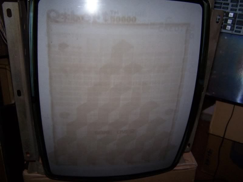

You can still do both... :cool2: I just bought some replacement tubes for my G07's. That way I get the chassis I want to keep and to get rid of nasty burn on two of my games.

I cheated in that I ordered known compatible tubes instead of hunting for a TV donor. You basically have to unmount the old tube, swap the purity rings, yoke, an wedges to the new tube (for what I am doing), and mount the new tube. Marketing where things were for comparison between tubes saves a bunch of trouble.
If your swapping a tube from a TV that has a yoke, you can check to see if the impedance matches on the two yoke coils. If they do, you can leave the parts on the new tube and just make sure you wire the yoke correctly to the existing chassis. There are plenty of tutorials if you do a google search. Some of the guys on here can do them really fast.... So it isn't a big deal. Just make sure you get the electronics right and have a compatible tube.
BTW - Crystal Castles burn doesn't look good on a Joust. ;)
