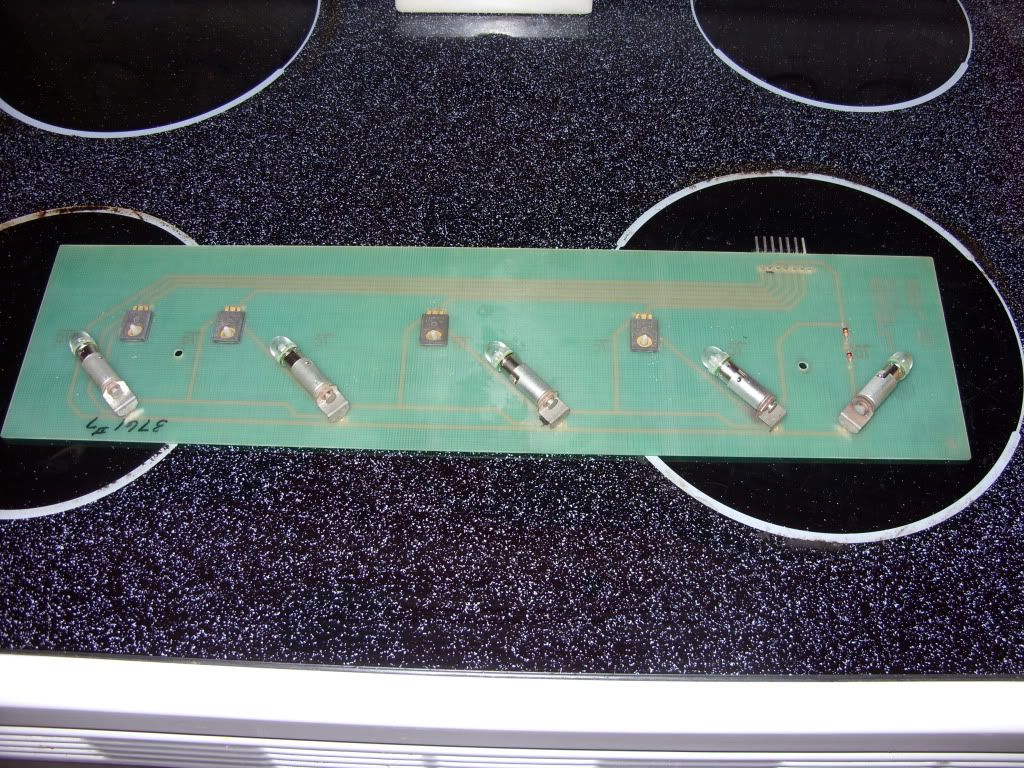

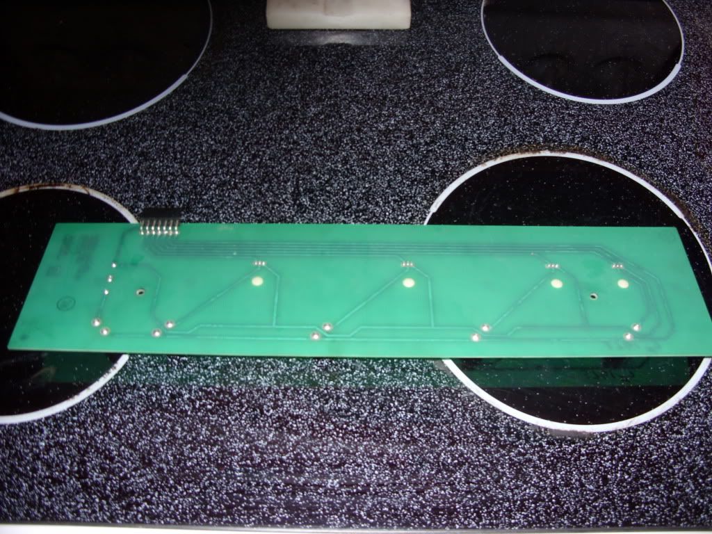

Also had a few Pms from people wanting to build a Lunar Lander from scratch that wanted pics of the original board. Here ya go!!

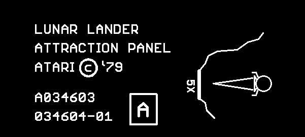

Based on a lot of good feedback from the community, it was decided to stick to the original Atari design as closely as possible, so voltage regulator and brightness pot have been omitted. The final product will maintain the original Atari layout, voltages and ship with the the original bayonet lights specified by Atari in the Lunar Lander owners manual.
- Replacement board is the same dimensions as the original Atari PCB (except the new one should be square rather than slightly irregular in shape)
- Mounting holes are slightly enlarged to work with documented variations in Atari cabinets (0.026" larger diameter)
- Header connector is the same position, size, style and meets or exceeds the original manufactures specifications
- All lights are in the original locations and ship with the Atari specified 13V lamp
- Circuit board is made from slightly thicker and more durable material (tighter fiberglass weave)
- All board will be shipped assembled and tested with 5 lamps.
Original PCB:

Old PCB Markings:
New PCB Markings:
