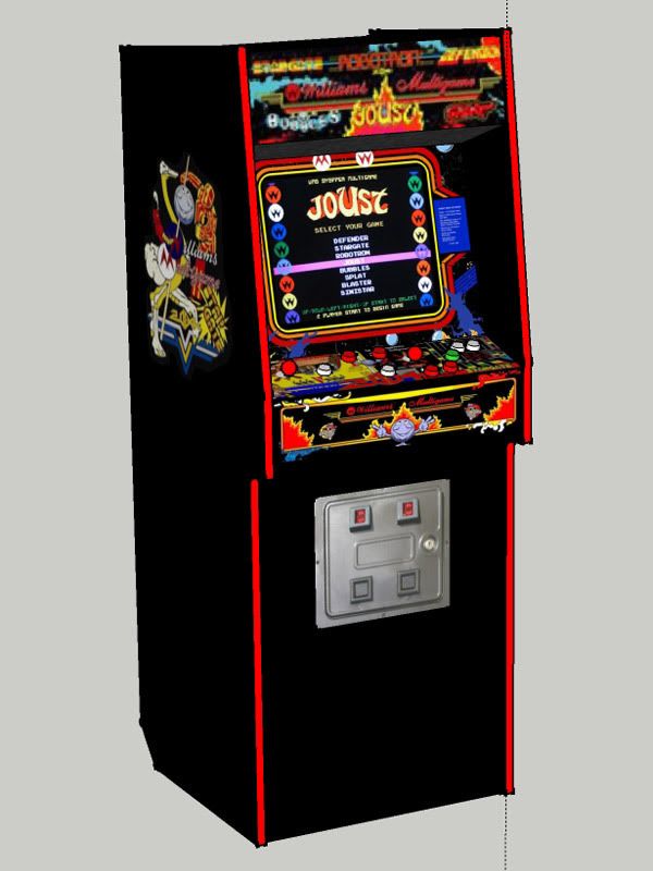

I can rotate and size the side art without issue... but its all tiled... so, for example, as I resize the williams multigame side art to the correct size, there is still a bunch of other images above below to the left and right of it.
How do I just get a SINGLE image rather than a tile of images?
I think i figured it out... make a square the size you want the side art to be then paint the texture in to that square rather than the entire side box.

oh man, that's the worst part. The ONLY way I've found to do it, is:
1. Go into a Paintbrush or other art program
2. Open the image
3. Stretch it's surrounded dead space by atleast half the width of the sideart on all sides.
4. Color in the dead space with a close match of the outer edge of the sideart's paint color.
5. Resave it
6. Reinstall it on the sides and as you install it, it'll have alot more free, clear space around it without showing the next tile's image.
7. Works best when black outer edge paint on black cab.
Trust me it's not fun, takes time, and is totally necessary if you want it to look good. I've basically had to do this in one way or another on almost every cab I've made for either the sides, CP, kick panels, or bezels. It sucks.
I use to be able to pump out a cab in 10-20 minutes. Now my anal perfectionist attitude makes each cab run 30-60 minutes. Just depends on the cab and the art.
