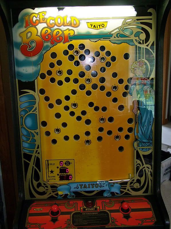

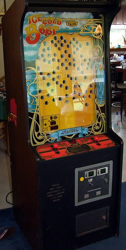

I picked up this game on the cheap today! As a parts machine... but I think it can be repaired.
She is a little rough (The glass that is) but cleaned up awesome! It needs side art as well.
I drove 300 miles round trip to get her...lol
1. It powers up, coins up, but it seems to be missing the bands it uses to move the bar... anyone know where to get replacements?
2. I was told switch #2 was faulty... I only have diagrams for 3 & 4 Does anyone know what this means and where to get replacements?
3. The bar seems to scrap the glass or playfield (the 2 little notches) is this normal?
Thanks! 1 more post of pictures after this one!

#1 - You can use standard automotive vacuum tubing with plastic connectors. I believe its 1/8 O.D. tubing that you want, which will be 3/32 I.D. I believe (but just measure it at the parts store. Remember to get two connectors for it. then you can trim to snug and adjust later as it stretches out by cutting a piece of the hose off and re-attaching the hose connector. I clamp mine where the connector is into the clamp that the holds the belt, that way it doesn't mind with the pulleys.
#2 - It may just need an adjustment or bend of the arm. They do look a little different than a standard switch, but it wouldn't be too hard to find a replacement or something that will work. I'd check it with an ohm meter first and make sure its closing the switch. Alot of times from all the years of that thing getting hit by the ball it bends the arm just enough that it won't quite close all the way.
#3 - There is little plastic bushings (rectangle) that ride against the playfield. Aside from replacing those, I'm not sure that you can keep it from rubbing unless something is bent or mis-aligned.
The trick to getting these to work good is clean all the old grease out of the bar that slides and both rods on the left and right. Lubricate the center of the pulleys with a drop or 3 of 3-1 oil, find something non-sticky to lube the bar and rods on the left and right. Make sure that the belts are equally snug and pretty tight, but not enough that its binding. If they're not pretty tight they will slip and the bar will not go up.

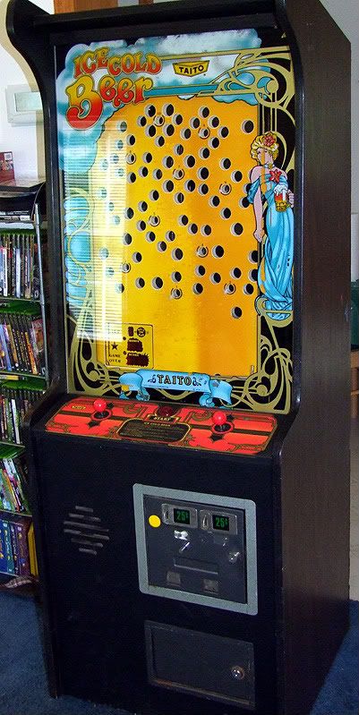

You mean these? :D After owning both I'd have to say that the ZP has an edge over the ICB but they're both kickass!
