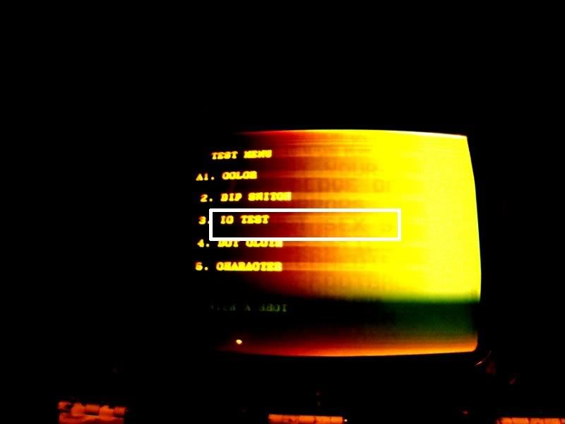

Okay, finally started really working on this a couple of days ago.
Got the LD player tested, boards tested (as best I could), NTSC decoder tested, cabinet cleaned, and a LOT of parts ordered (last bits of the harness I was missing and cable for the LD player control).
Spent this morning cleaning the monitor and chassis. Got that done atleast while I wait for the other parts to get here.
Monitor still needs a recap (among the parts I ordered).
The only part I forgot to order was the connector for the RGB/S/G on the chassis... I HATE when I do that.
But, everything else should be here soon. I'm going to hold off on the side art and stuff like that until she's 100% running.
Right now I still have to trick the LD player into running and still can't hear much of anything but static (missing the pots and harness piece that plugs into them... on order).
Even WHEN everything gets here, I'll still be short a bezel and smoked plexi/glass... but this is good enough for now.
Well, last part came in finally. Big thanks to johnny1 for selling me a scoreboard. The one that was supposed to come with the kit never came in and the seller stopped responding to my messages.
Eitherway, finally complete as far as parts. You can see the sideart and CPO on top of the machine waiting for me to order in some vinyl.
