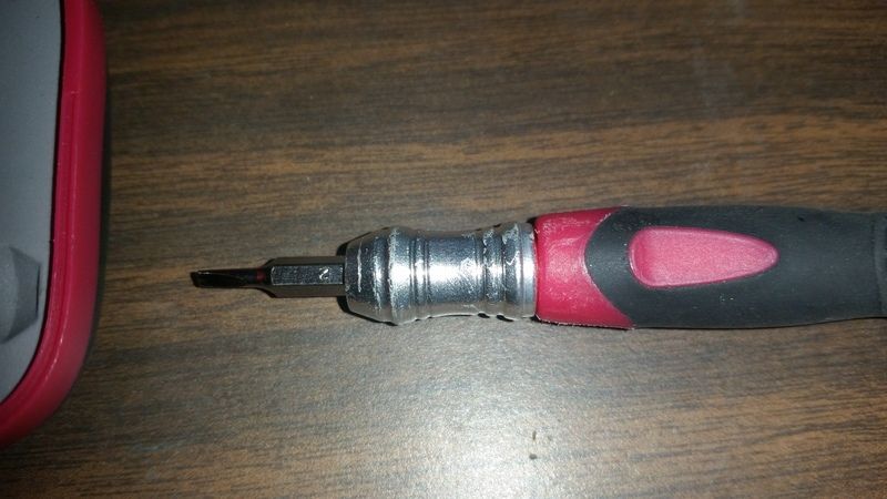

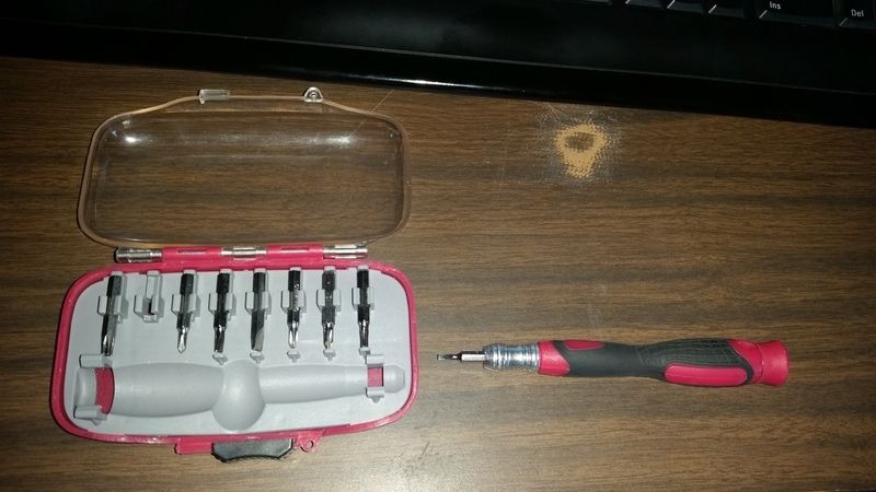

You are best to use a non-conductive screw driver to adjust B+. Bob Roberts sells a plastic tool kit with 4 or 5 tools in it, one of which will work to adjust VR601. HOWEVER, in my case at least, after 3 or 4 uses, the ends of the tools deformed to the point that they no longer turned it. I have a small screwdriver with a plastic and rubber handle, and the smallest flat head bit works perfectly for these VR's. The bits are the only metal part on the screwdriver. Will try to get a picture of the set, and a make and part number, in case that info would be useful to anyone. You don't want to go sticking anything with long metal parts into your chassis. You also want to be extremely careful reaching around in there with the monitor on. Alternatively, you can adjust with power off, and turn it on to check, then power off and adjust, rinse and repeat. But, that can be time consuming.

BTW, here is the screwdriver set that I use to adjust VR's. There is no identifying information on the set. The bits are stamped "china" and then what appears to be some sort of size information. The flatheads are 'china 2', 'china 3' and 'china 4'. The smallest ('2') is the one I use for the VR's. I'm guessing that translates to 2mm.
