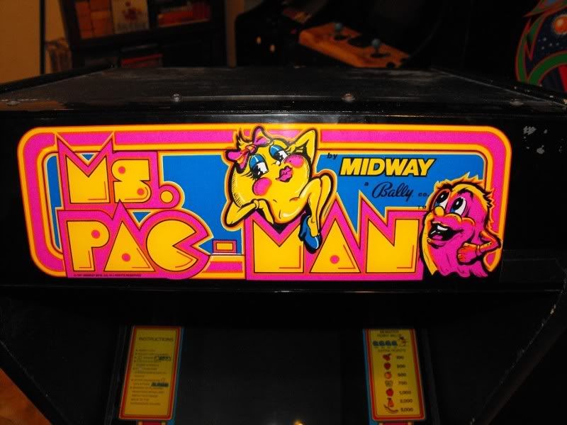

Saw the ad on CL a few days ago... didn't think anything of it because it NEVER registered to me that it was a mini... thought it was some kind of half frankencab at first... till it was pointed out to me earlier today that "it's a mini, dumbass!" (paraphrasing actual text, direct quote of everyone's thoughts).
So, I thought I missed out on it... turns out I made it just in time... emailed the poster, got her number, called her up and got the hell outta the house when I realized I still had time. Went to the job, got some money I was owed (and I think maybe extra?... I'll have to do the math on that later)... Hightailed it to the ladies address, and of course was almost late due to what appeared to be a herd of wild blue-hairs in front of me (25mph in a 45mph zone... the whole way...). Got there RIGHT AT 3PM (when I was told ot be there by), checked out the cabinet to make sure the monitor was secured, checked out the plug, gave the cash, and was on my way out when I noticed their Multicade wasn't working (on freeplay in a pediatrics place)... so I set the dolly down, fixed their multicade real quick on my way out, and headed out.

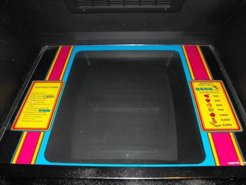

Anywho, she's been covered with black vinyl... but you know... it doesn't look half bad... I'll take care of it later, but I'll leave it on there for now.
Oh, and I now have a cabinet with a full backdoor! It's a miracle!!! Of course the coindoor would be screwed up... but, backdoor!!! (my other machines don't have them... their kinda ass in the breeze as far as those go).
