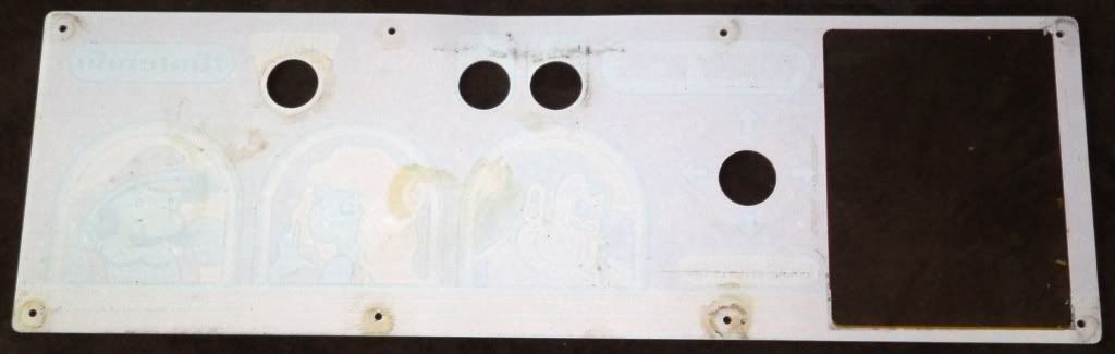

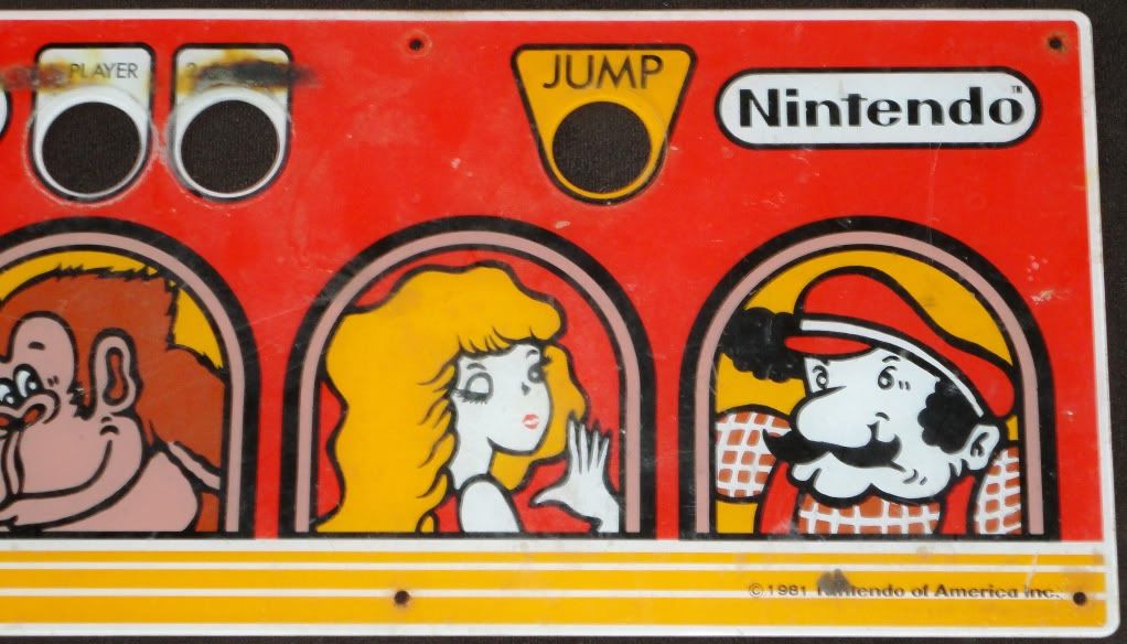

Some of you will recognize this CPO from my Donkey Kong Control Panel Restore thread...
http://forums.arcade-museum.com/showthread.php?t=197628

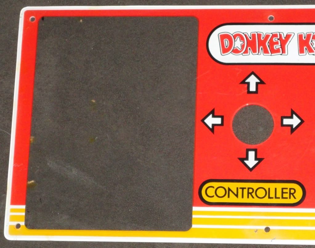

I didn't use it in my other restore and it has been sitting in my closet ever since it was removed. I felt bad for the little feller so I have decided to improve his quality of life and possibly make hime usable again. Here he is as he is currently...

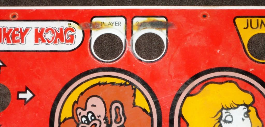

And some close-ups of the ugliness...
This is my materials list of what will be used during his "procedure"...
500 grit sandpaper
1500 grit sandpaper
Power Drill
5" disc attachment and 5" buffer pad
2 rags
NOVUS 1, 2, and 3 plastic polish and scratche remover
Later I will update the progression of our fallen and almost forgotten friend.

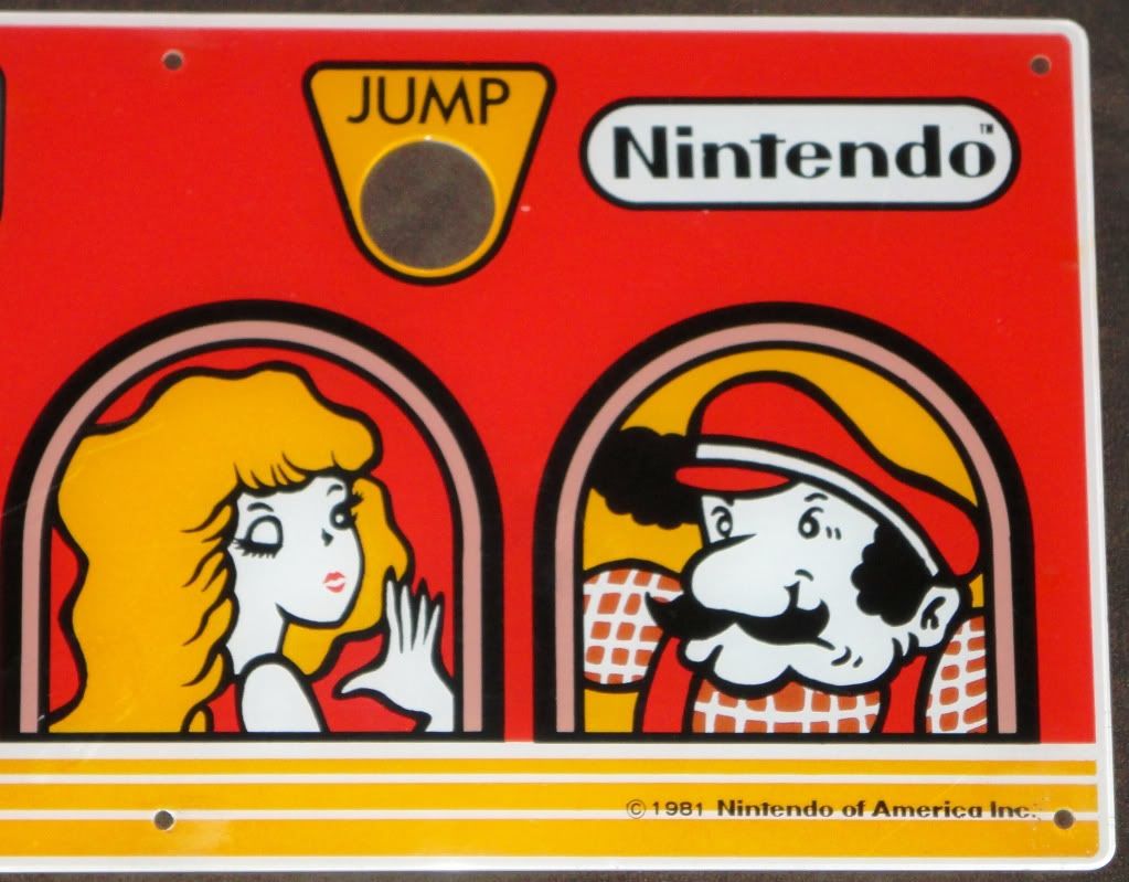

After 2 hours of work this afternoon, this CPO is coming back to life. I could do more but I ran into two issues...
- I am running very low on NOVUS.
- My battery on my drill died.
I was amazed at the NOVUS though. Not because of what the end results look like (I have been an advocate of the product for years), but the fact that this is the first kit that I bought back in 2005 and it has finally run out. Talk about bang for your buck.

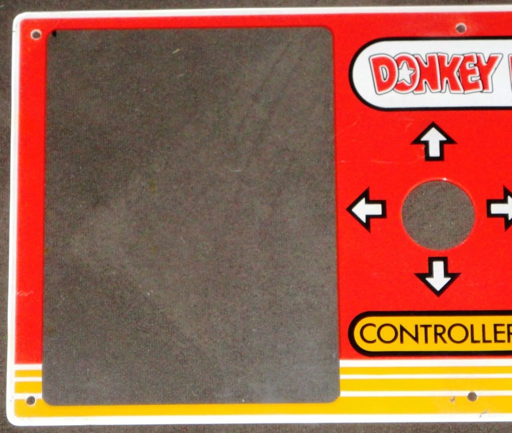

Anyways, here is what was accomplished today...
And close-ups of were the ugliest parts were...
There were an obvious defect that I couldn't fix. The area that was burned the most by cigarettes was warped and you can still see that in the updated pix. I also need to get a new instruction card. After I get more NOVUS I will put the finishing touches on this and I think it will be usable again. It's not perfect (and never will be) but it isn't an eye sore anymore either.

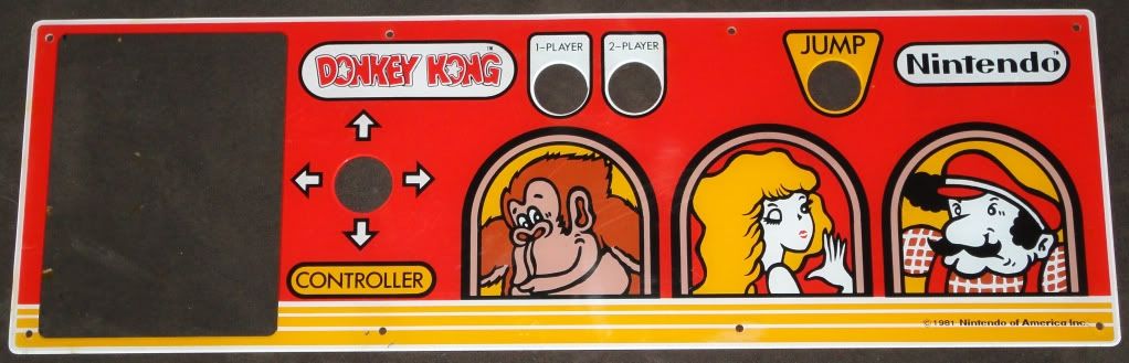

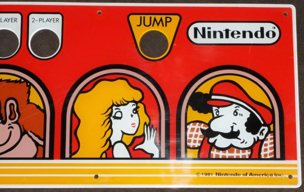

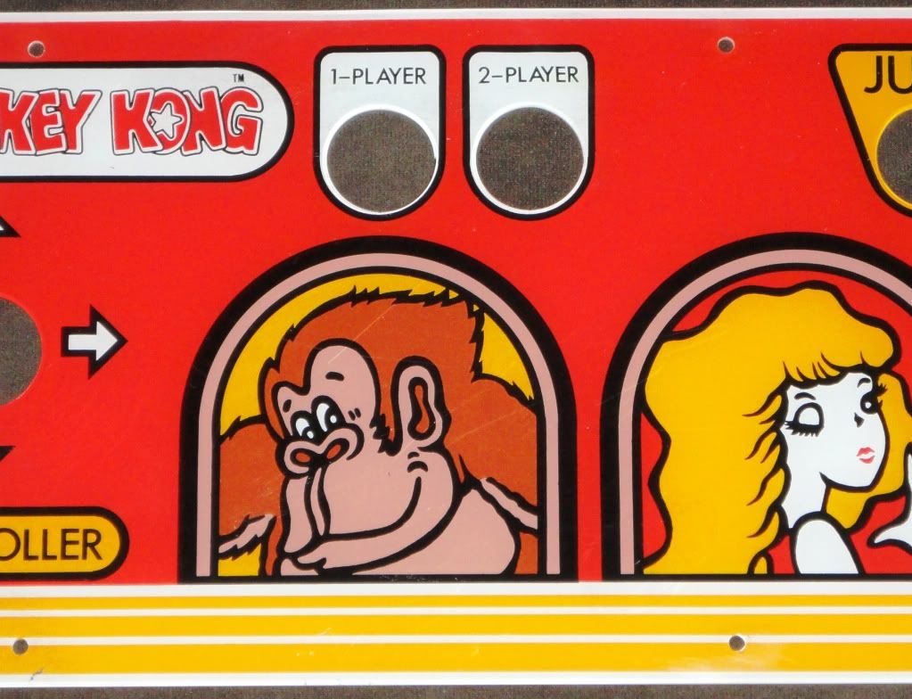

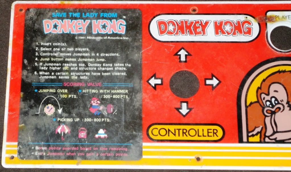

Totally done and totally out of NOVUS. I spent a couple more hours on it today and it is as good as it is gonna get. All deep scratches are now fine scratches and the window for the instruction card has been cleaned up. No more dull patches under the jump or start buttons. The only major flaw is the slight warping above the start buttons from the cigs. Couldn't repair that without damaging the art underneath. Check it out...
Now I will probably sell this one off.
