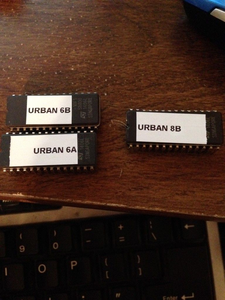

So anyone that doesnt have a burner that would like the chips for
Mario bros
Dk
Dkjr
Dk3
Feel free to pm me, ill burn and ship.... Was thinking $10 a set shipped......
This way more people can play them and make sure there isnt issues....
As more games come up, and i have time, ill test and add them to my list of willing to burn.
Hopefully this will help get more vs projects underway

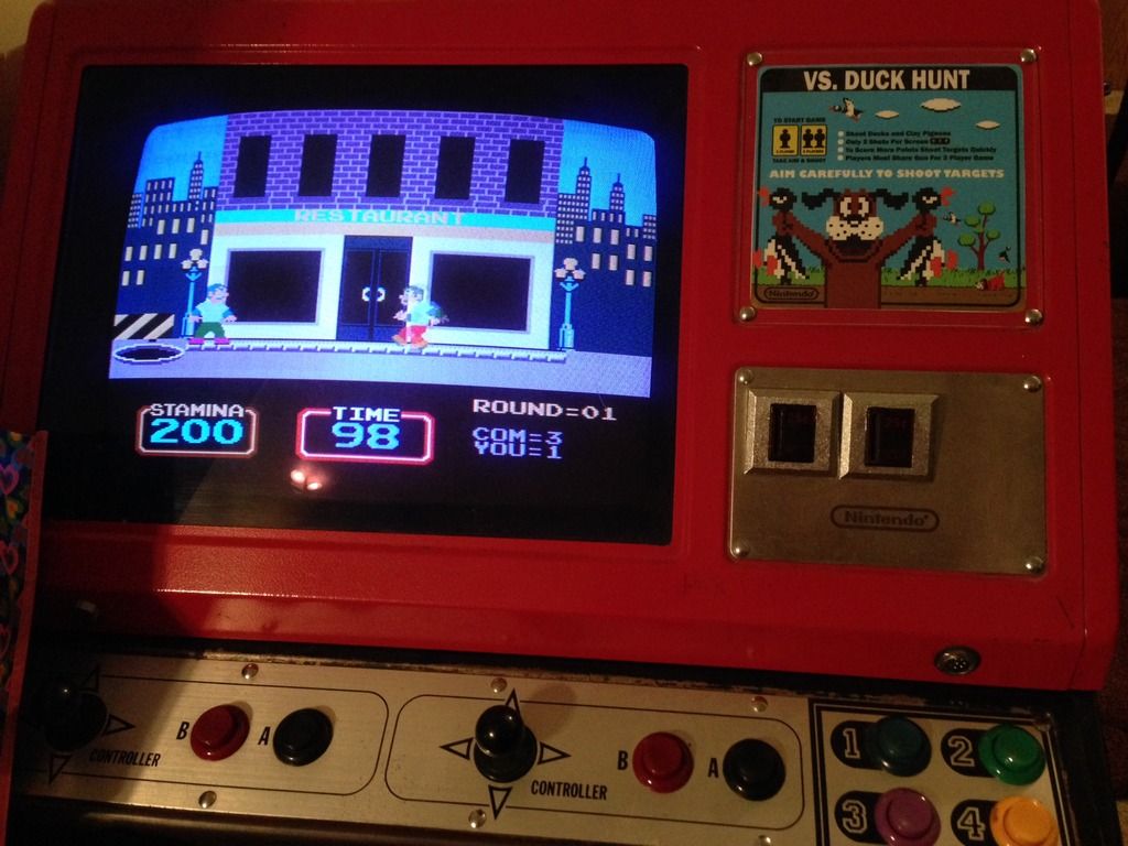

I got down to running through all the NES ROMs in my collection. I posted the results of my testing here. I came up with 102 different ROMs which work in MAME.

So what games will work with the vs board? And what ppu are you guys using?
joe3693
Jul 14, 2012
2,625
85
east troy, Wisconsin
Based on his mame/vs testing its possible that those 102 will work.
As far as actual testing, since you have to physically burn chips and put them on the vs board, so far I personally have tested mario bros, dk, dkjr, dk3. As i have time ill try to burn some and test them. Or if someone has a request from the list in the link above, ill do that first. It will take sometime to get threw the whole list, unless more people want to burn and test.
The ppu is the rc2c03b, rc2c03c, or rp2c03b...... More commonly known as the duckhunt/tennis/playchoice ppu. It is the same pallet that the nes uses.
