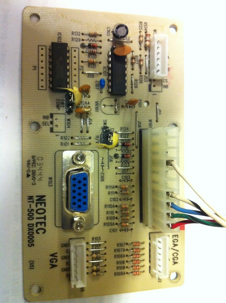

I'm working on a Golden Tee with an Neotec NT-500DX tri-res monitor. It would only display the little colored "no signal" box when in CGA or EGA mode. I hooked it up directly to the VGA out of the video card, and it has a beautiful picture.
What would cause it to work only in VGA mode?
Also it clicks 2 or 3 times when you first turn it on. Is this the power supply, or the monitor switching resolutions?
This is my first time messing with a newer digital tri-res monitor.
there's to sets of three pins with a jumper on the RGB sync board. (the little board on the side or back) move the jumper on the top i believe to the other two and try it again. I know it's something with those pins. that control the resolution.
Here's the board. I was under the impression that all you had to do was hook up the proper input, then switch the output wires to the appropriate plug (EGA/CGA or VGA).
The 3 pinned switches, Sw1 & Sw2 are glued in place and labeled: H/V and COMP.
Any more info on this monitor? Are the switches on the input board for sync? Comp or H/V?
I changed one of the switches from H/V to COMP, changed the inputs to CGA/EGA and it still had no signal, but it clicked a lot more times at startup.

Caps?
if signal interface board is good and cables hooked up right.
Check the X901 is solder in good for the micro.
Next check for a shorted mosfet like q709,q707 irf640
also reading th FH or frequency table on schematic will tell
you what mosfet drive trans is turned on..for each res.
Test point is S0,S1,S2 to the base of each transistor{2sc945}
then to a mosfet for scan,If no shorts in the scan circuit
then replace the Caps
Have to search for a cap kit if needed.
if you can't find a made up list then
start pulling them to replace, record the location's
and uf list for each cap.
after you done add your list and caps,to a bag and start making
millions of dollars selling a NT-500 cap kit!! LOL
Good Luck!

That's good info, thanks. As far as I know, I'm hooking things up right, and I assume the interface board is good, but I guess I can't know for sure.
I'll pull the chassis and start looking for bad solder and bad caps, then check the mosfets.
