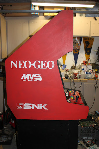

Can anyone take some measurements of where the lettering is placed on a Neo Geo cabinet? Maybe a measurement from the ground up and from the back edge for each of the three sections, Neo Geo, MVS and SNK?
I got some new art for mine and need to know where to place it. :D Also, feel free to post pictures of your Neo cabinets and projects!
Well... mine is a Z-Back so it's not going to be original regardless. I'm just looking for some general ideas of how to get close. :)
On an original Neo cab the "Neo Geo" logo is basically just below the angle change in the cab's side. The lower "SNK' logo is just above the angle change for the control panel. And the "MVS" logo is about 3-3.5 inches below the "Neo Geo" logo. The "MVS" and "SNK" logos should be centered with the "Neo Geo" logo.

Cool, thanks!
yes on mine it's lined up with the angle also.
