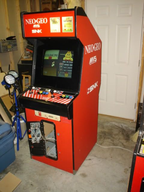

after discovering my brother's monitor on his mame cab (a billabs mulisync) will not work with MVS, we found a pretty good deal on a 25" neo cab. so here it is. cpo/plexi was shot so I already took that off. plan on sanding down the cp and painting it then tossing a new cpo on there and some new buttons/sticks, have some temporary buttons on there now. cab is in ok shape, needs some work but they usually do. it came with a one slot and the 100-1 cart. monitor picture is great so that's a plus.
plan on putting a 2 way switcher in it and having a 1 slot for the multicart and a 4 slot for other games, should cover all the bases.
the seller also had a lot of marquees, all for $10 each, and luckily for me he had a really nice defender since mine is in pretty awful shape.

i found a cpo and 4 slot mini marquee that should work out nicely, so next step is to sand down and paint the cpo and get rid of the 100-1 cart instructions. I guess someone actually was making money off this thing with the 100 in 1 cart, pretty crazy but I guess no one really cares enough to stop them from doing that.
i took off the extra coin door security which I found annoying.

well I've heard the 100 in 1 has problems with multi slot boards. I've heard someone got it to work by not using the other 3 slots in a 4 slot, but that's a pain, the 2 in 1 would be much easier. only problem is jammaboards is out of them and it says they are discontinued, so not sure what I'm going to do now, maybe somewhere else has them.

the 4 slot does work with the 100 in one, but it pretty much turns it into a 1 slot. i tried having it in slot 1 with 3 other games in the other slots. picked a game on the 100 in 1 and it started one of the games in the other slots. so I still think it's worthwhile to toss a 2 in 1 switcher in there to go from a 1 slot to a 4 slot so I don't have to change games all the time.
