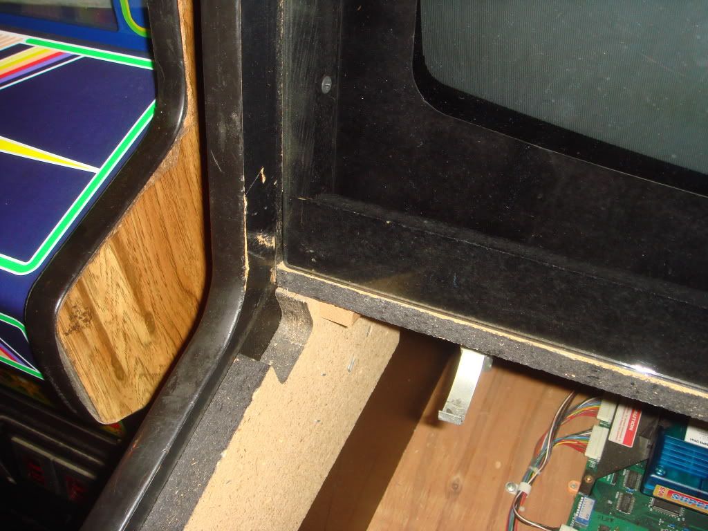

I picked up a Neo Geo MVS cab that is missing something in the bezel area (brackets perhaps). Can someone post a pic or two of their cab with the glass off so I can get an idea what I'm missing? PLEASE...

What I need to know is if there is supposed to be some sort of rail (wood), or bracket to hold the monitor glass in place and how the bezel mounts inside the cab. A few shots of a cab with the glass off will tell me everything I need to know.
It's a dedicated MVS-2-25 cab

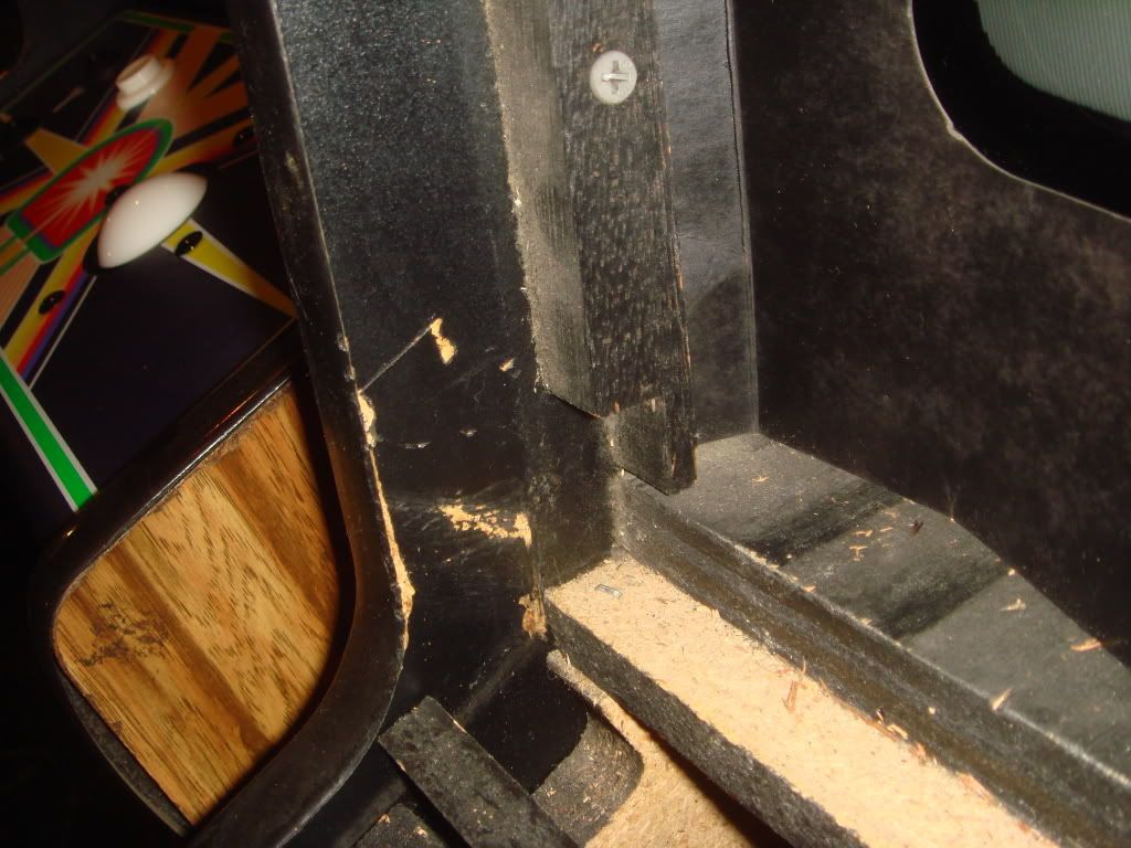

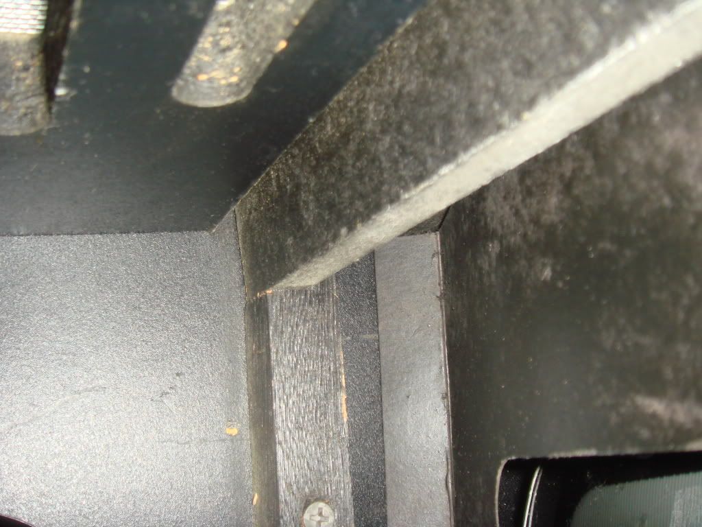

Here's the deal. My glass sits about 3/4" behind the lip on the control panel and there are a few screw holes along the edge like the glass is supposed to rest on a rail or something. I need to see how the glass is supposed to sit and how the bezel mounts.
Ok, I gotcha now, will take some pictures when I get home. Fortunately the "rails" you are talking about are just 3/4"x3/4" strips. Just be sure the screws are short enough that you don't shoot them through the sides.

Well, here is what I got.
I forgot to measure the distance from front to the rails, but you should be good to go with the pics.
The top and bottom wood are NOT fastened in, just set in place.
The sides are held by 2 screws each.
-Bottom/top boards are 1/2" by 1-1/2" and go side to side fully.
-Side boards are 3/4" by 3/4" and are notched top and bottom to cradle those boards.
pics......
