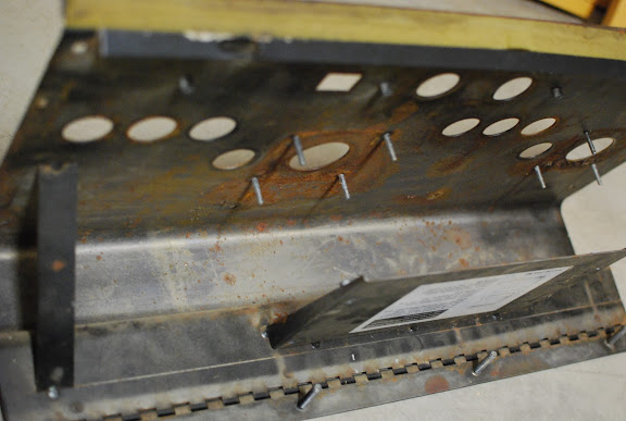

- Lots of CP rust. No CPO or memory card/headphone jacks sticker. Needs full restore.

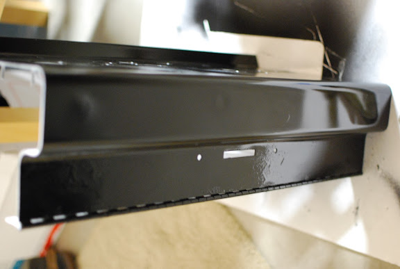

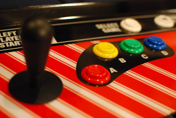

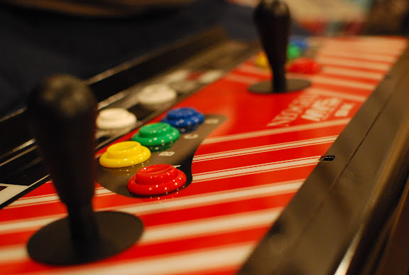

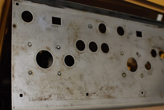

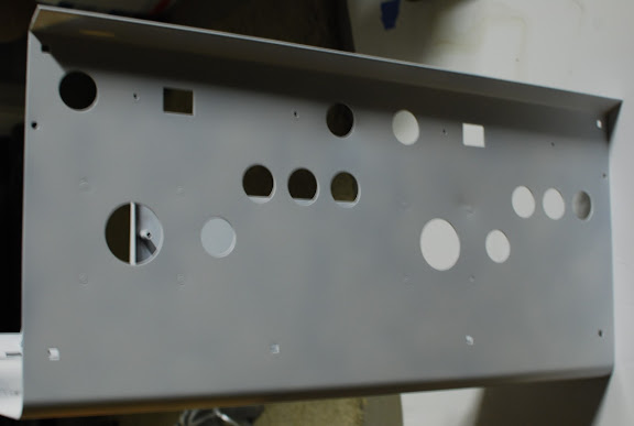

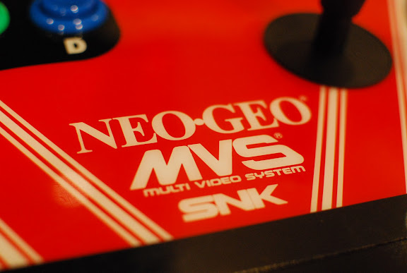

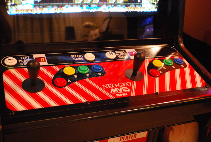

I finished restoring the control panel:
- Thanks to djdns, I got a nice original CPO. It took me a long time to find as no one reproduces these original thin plexi CPOs. I also found out that there are different CPOs depending on the version MVS cab where the button holes are laid out differently. So I'm happy I found one.
- It was extremely rusty and I sanded it down. There was some pitting, but not too bad. I then applied Rustoleum 2X Primer and Rustoleum High Performance Black Enamel.
- The CP bolts were rusty as well and I sanded down using the power drill method (putting bolt in the bit slot and sanding against sand paper/block). I painted them black as they were originally. They aren't in the pictures because they were drying at the time.
- Installed standard HAPP Ultimates (I know they aren't as good as Competitions, but you don't need "nice" joysticks for MVS games) and buttons.
- I plan on printing and laminating this (http://hardmvs.com/manuals/Memory Card Sticker.tif) from hardmvs.com to serve as a replacement for the memory card/headphone jacks sticker.

Looks great thus far. Keep us up to date, I need to get working on my MVS 4 slot and yours will definitely inspire me. When you get a chance, let me know where you got your CP repro'd and what you decide to do about the front and side artwork.
The CPO is original, not repro. I bought it from a fellow KLOVer. No one makes repros of the original thin plexi. You can buy an adhesive overlay and put plexi over it but that's not "original."
I plan on just trying to touch up the sides and front art with white paint. It will be in a row of games so its not a huge deal for me.

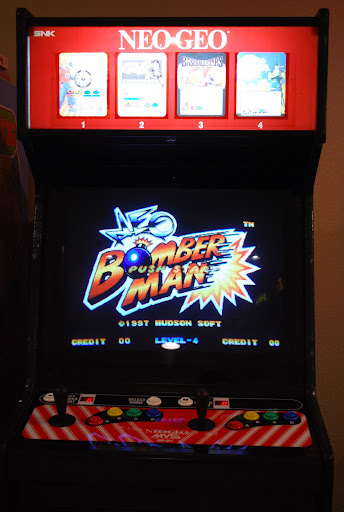

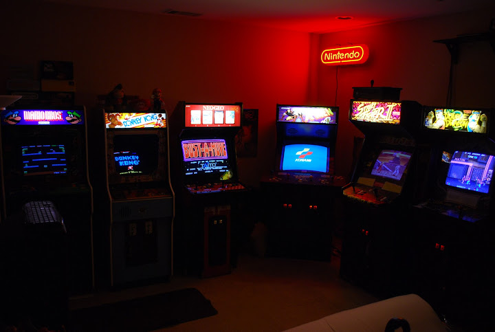

Posting this a bit late, but I moved this into the game room just in time for Christmas. It definitely adds character and variety and it's so fitting to have it next to the other JAMMA games I loved as a kid. Minus Championship Sprint, the JAMMA row is almost a splitting image of what my hometown candy shop had at one point when I was a kid. Here are some more pictures.

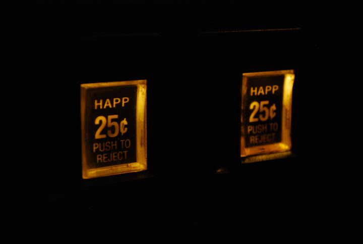

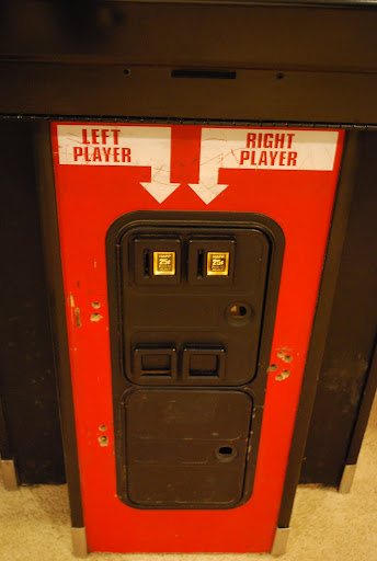

Nasty lock bar holes:
I like lit coin slots:

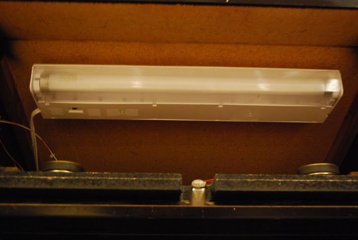

$8 light fixture from Walmart:
Plugged into the extra outlet on the PS:

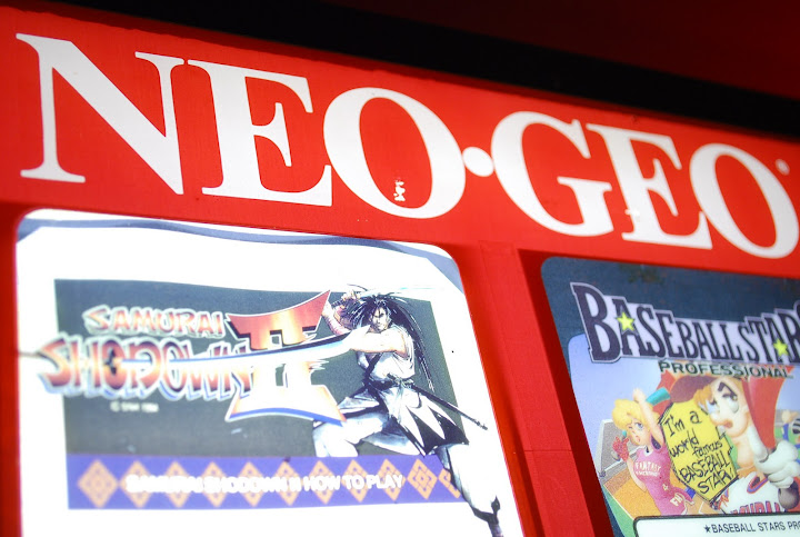

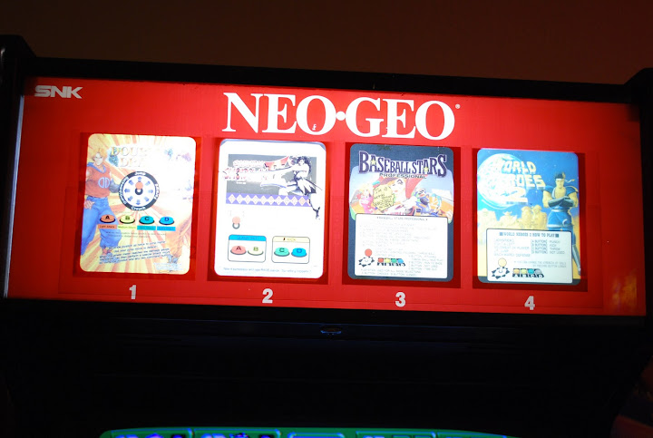

Marquee is in fair condition. Need to print and laminate some inserts:

nice lineup!
I would swap the Nintendo cabs and the MVS for the DD. This way you have it almost chronological left to right!
I have the same machine and i for my restore i plan on putting digital picture frames up where the marquee is and cycling artwork since i will be running a multi cart. I think someone on neo-geo did this and it turned out great and with the cost of dig picture frames dropping like crazy it would be a very inexpensive mod.
I dunno, that sorta destroys the subtleness of the original marquee and draws a little too much attention to the marquee. It screams "look at me" which isn't very me. Cool idea. Different strokes...
I wish they still made replacement EL panels as I would go for it actually. I like the original but too bad the life on those was so short.
I dunno, that sorta destroys the subtleness of the original marquee and draws a little too much attention to the marquee. It screams "look at me" which isn't very me. Cool idea. Differen stroks...
I think this guy will make you something custom for yours if needed.
http://www.glowhut.com/el-strip--el-panel.html
I'm going to email them about making replacement kits.
Someone used to do that but no longer does.
