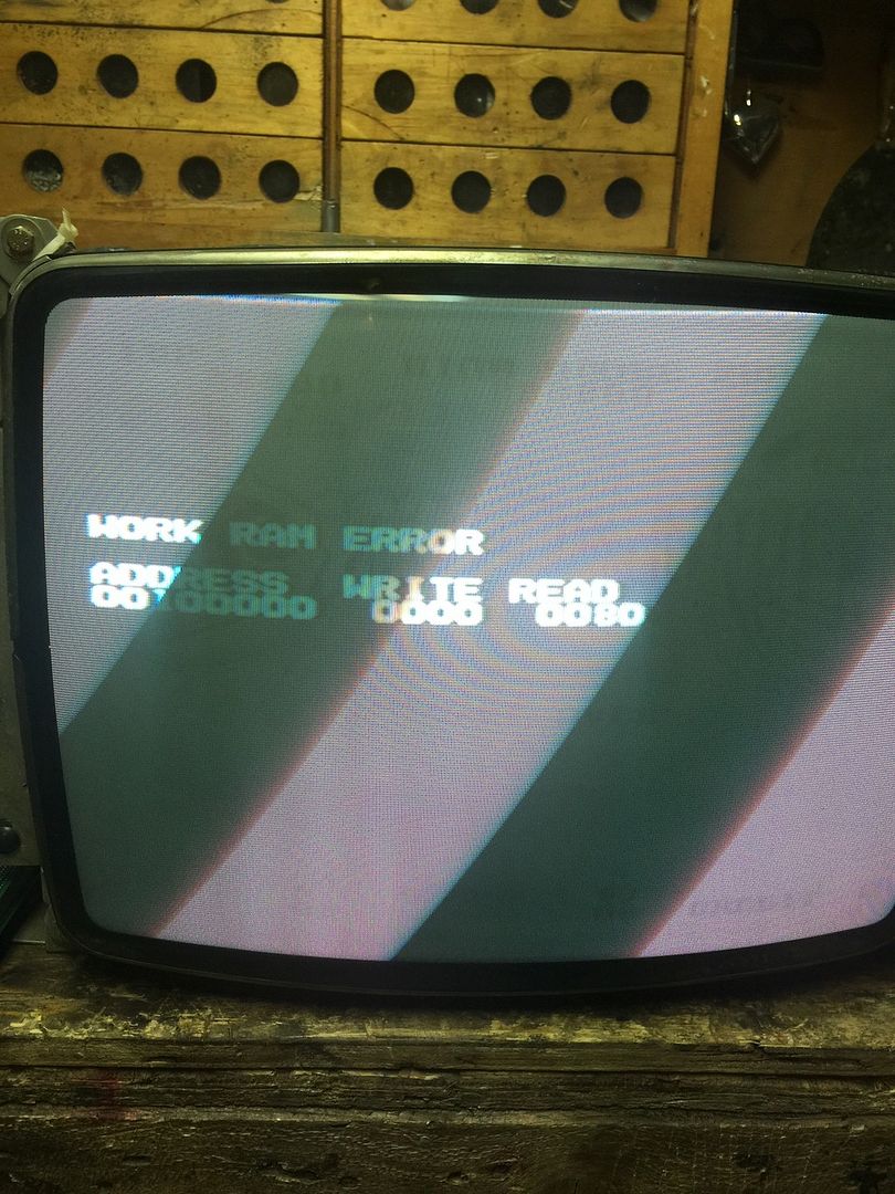

So I got this board local and it was in storage , dust caked onto it. I cleaned it all up , got some games and plugged everything up and I get nothing. I started checking voltages at the harness to see if I was getting 5volts and by accident I touched the ground with one of the red wires with the multimeter prong and this error popped up on the screen
I also can't re enact that scenario again...the screen just starts blinking or a white screen shows up for a sec with some pixel boxes. It's probably not a good idea to keep shorting the ground and 5v lol. Also my harness is wired for a data east pcb if that helps to determine the problem
You killed some RAM. Which ones, no idea.

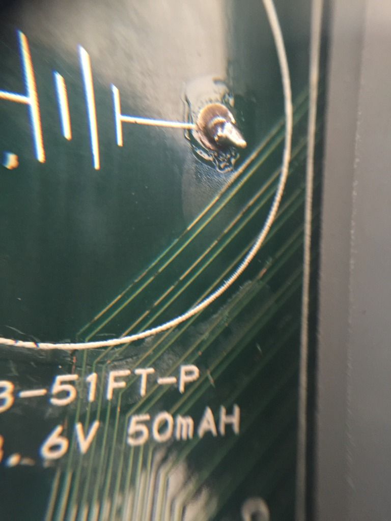

Did the battery mod, battery looked super clean without corrosion.

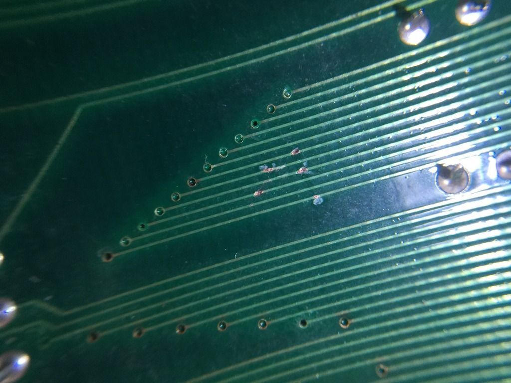

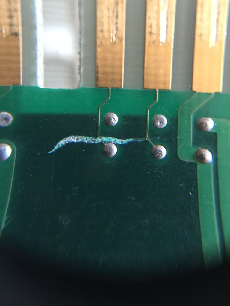

Went over the bottom board and found a couple of iffy traces. Are these considered bad and should be fixed?
Check with an ohmeter of there is continuity between the sections that the scratches Cover if there is a break then fix
