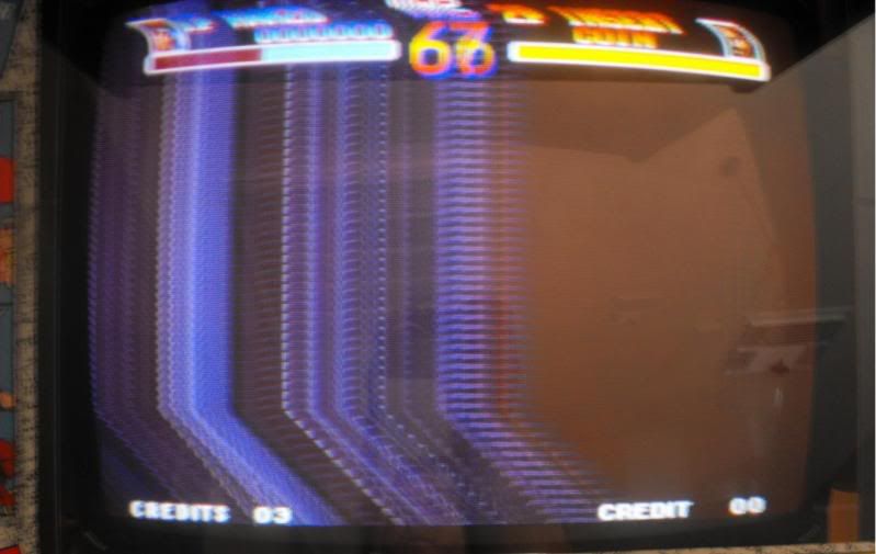

I have a 2 slot neo-geo board and was getting a Video Ram error. I replaced the ram and got the board to boot up and now the background and sprite graphics are missing. Didn't find any broken traces, any suggestions on troubleshooting / fixing this? :D

I assume every cart does the same thing? Have you tried different carts, yet?

Yeah I posted over at Neo-Geo.com. Haven't tried other carts as I only have the one. :D I bought the cart working to try the board out.
Then there's your next project. Use a different cart next to see what happens.
Hrmmm...
Last time I saw something like that it was a bad LSPC chip... It could still be a bad trace though.

Make sure all the JAMMA edge contacts, the cartridge contacts and the 2 PCBs of the Neo Geo are clean and making good contact. I had some strange behavior like this and it was just dirt.
Look at the writing on the custom chips. You'll see one with that on it.
Yeah I looked it up yesterday. I wouldn't even try messing with that. Do you replace those? That's a lot of small pins to solder.
