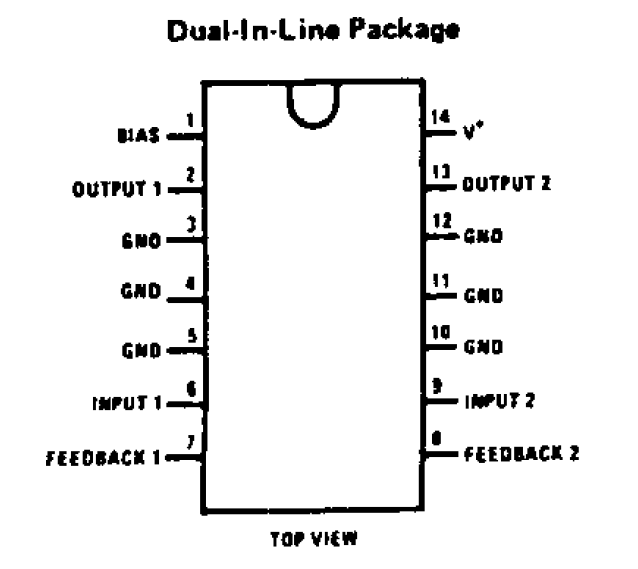

Here is the Audio Schematic for SI Part 2:
Now, we can see that the Speaker- comes back to pins 3/4/5/10/11/12 of a chip labeled as an LM377. Looking up that chip shows those pins are tied to ground:
Therefore, Speaker- is tied to ground. Normally this is tied to the ground on the board, so it comes back to the connector, but I've sometimes seen people just run a wire from Speaker- on the speaker to a nearby ground - and had it work...
