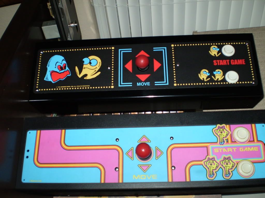

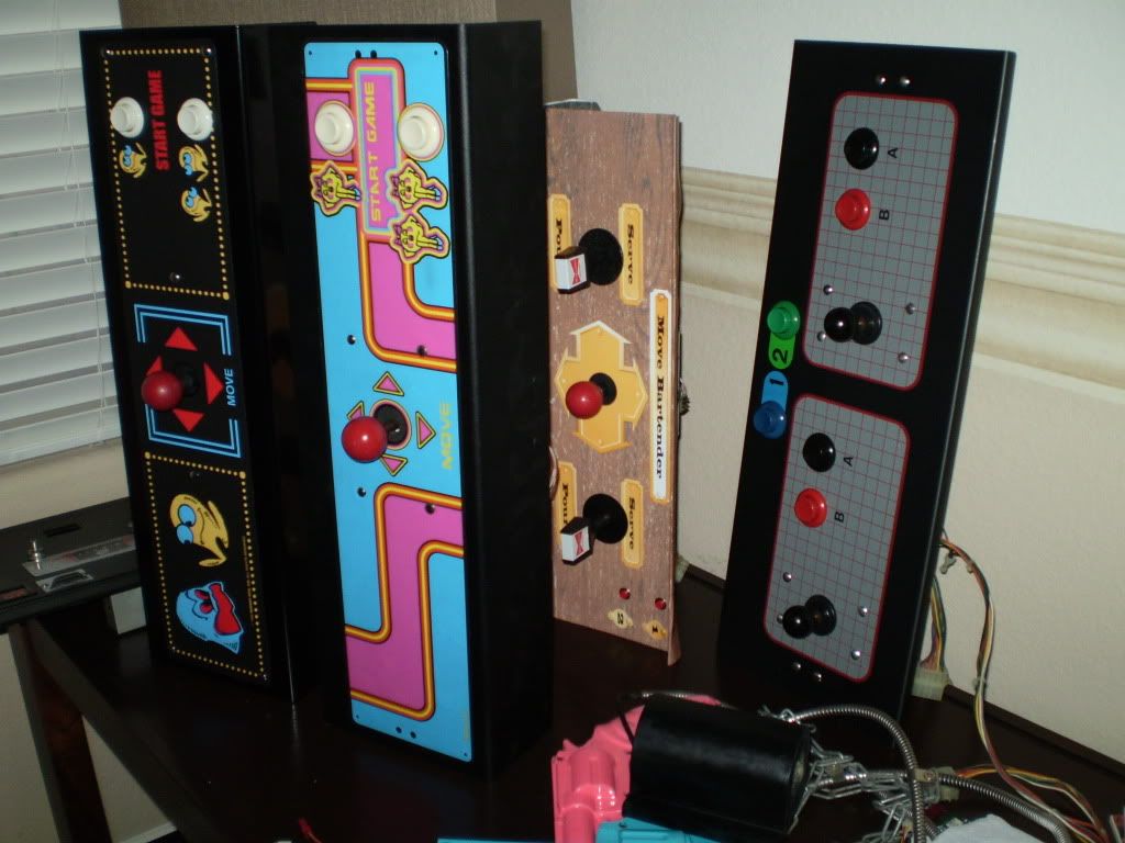

Here are a few pics to Pac and Ms Pac that I have powdercoted from the start, then applied artwork.
