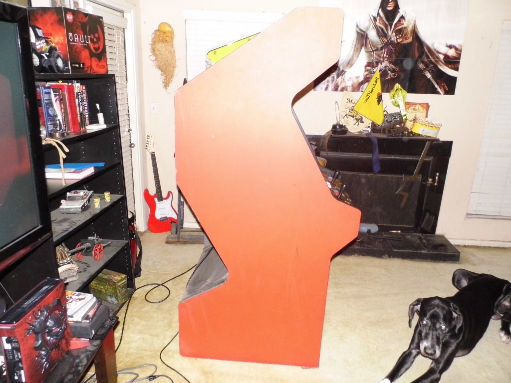

I got this cab
I put a 19-1 board in it tonight that i got from NIXS on here(which works great btw)and now its up full volume. I searched every where for a volume control and cant find anything. I checked the 3 wonders board i took out and could find no volume control on it either,does anyone know where the hell it is?
