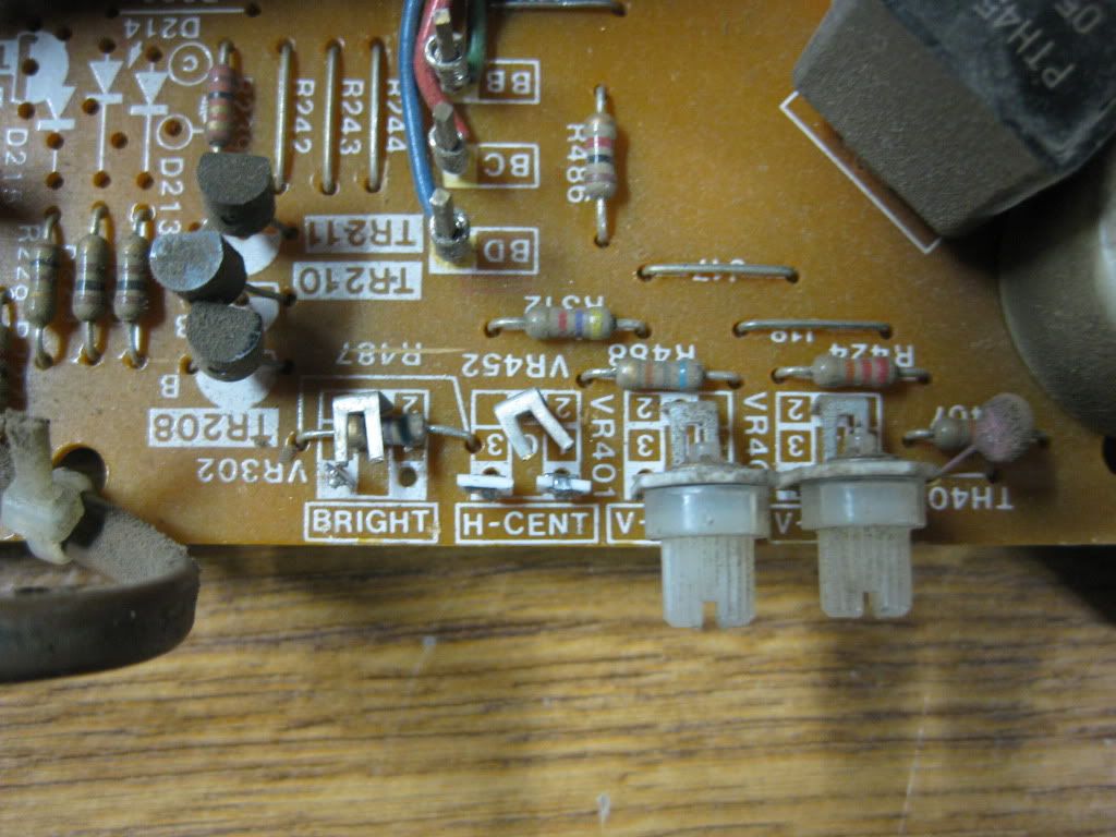

I'm not too good at reading schematics yet, but I'm trying to learn. Here's a pic of the pots I need to replace:
attachment.php
It appears that the H-Cent pot is VR401 or VR402. The Bright pot is definitely VR302.

That's a "non-regular" Sanyo. Someone else posted a pic of one recently with all the pots. Contact them for the info...
i have the exact same chassis here.
and i took it apart just for you.;)
i don't know the location # for each pot but i read the label on the front of the monitor as i was looking at the values.
they are all 6mm leg spacing for theses 4 pots.
brightness 103 = 10k
H-Center 204 = 200k
V-Hold 204 = 200k
V-Size 503 = 50k
i have all the pots you need but they are not side facing so you would have to make a remote board.

Thanks for that, Mike. I have the chassis in hand now, too, so I was able to take some better pics.
Here's the missing pots:
And the overview shot of the chassis:
Looking at the close-up photo, it appears the pots I need to replace are VR452 and VR302. I'll see if I can find the proper manual for this monitor and identify the specs on these pots.
ok looking at yours and mine.
the values i gave are correct.
brightness 103 = 10k VR302
H-Center 204 = 200k VR452
V-Hold 204 = 200k VR401
V-Size 503 = 50k VR40? i can't see the last #
Peace
Buffett
