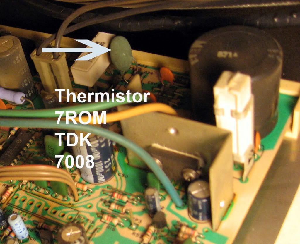

On my WG 7000 series chassis My R105 Thermistor is burnt off the board.
The WG manual calls it: R105 043X0485-001 Thermister
There are no values listed. I see Mouser has 180 pages of thermistor listed.
I am lost. Any direction would be helpful? Should I just email Bob Roberts?
Thanks guys!
Here's an image of it, plus more info I found.

Looking at the schematics, R105 goes to the Degaussing Coil.
So maybe we can live with it broken? I do have a degaussing coil I can use.
This makes perfect sense, because after moving this game, I had to use my
degaussing coil on it.
I needed a thermistor for a K7000A (Zenith built). I know the chassis are interchangeable....not sure how close the degaussing circuits are.....but....here's the specs on that one....
7 ohms
20%
140 volt max
