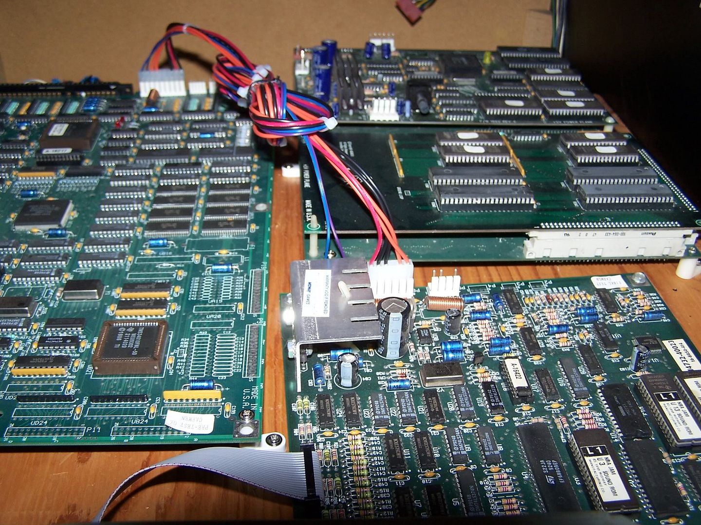

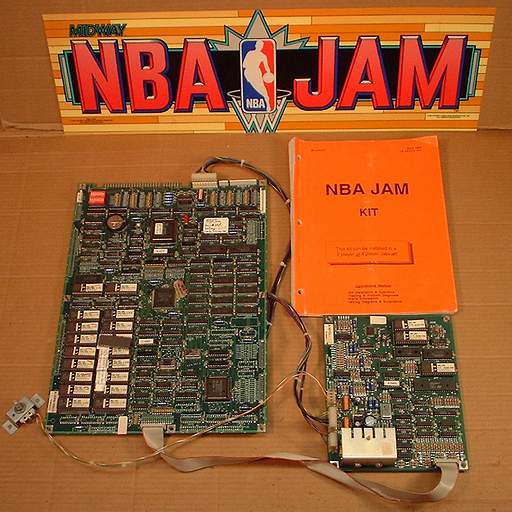

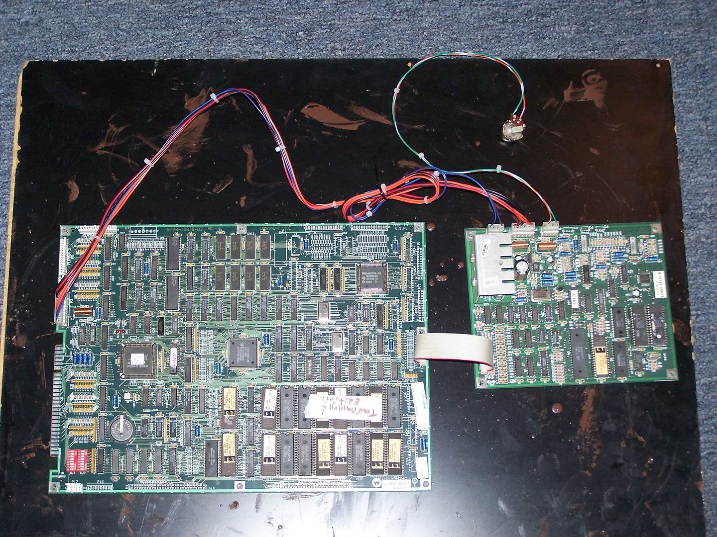

If anyone has a pic of there nba jam board with sound board i would appreciate it. Just bought one and it only came with the ribbon to connect the boards together and im pretty sure im missing a set of additional wires.

if you want to get up close and personal here's links to high res images:
http://img.photobucket.com/albums/v218/nismo240sx1/Arcade Game/NBA Jam/100_0842.jpg
http://img.photobucket.com/albums/v218/nismo240sx1/Arcade Game/NBA Jam/100_0803.jpg
MK2 harness will not work, mk1 must be the match. I checked my MK2 harness and it has 8 wires in 1 molex vs. 5 wires + 2 on 2 molex's that the NBA Jam has.
you'll also need the volume pot to get audio as well as the power harness (and the ribbon cable which you already have).
