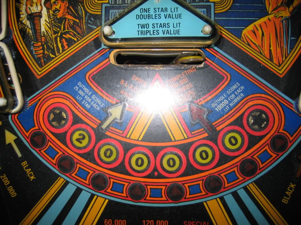

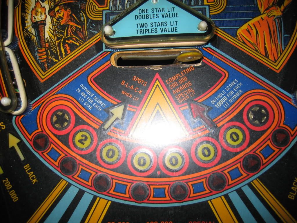

Hey folks,i am in need of a straight down pic of this section of playfield.It will save me many hours photo shopping this one.My goal here is to print a decal consisting of everything inside the blue lined triangular area.from the moving target down.The plan is to print this off and stick it on the playfield,then using a brush,blend the edges in so it is not so obvious.Then finally clearcoat it.
Not my pics, but they might be enough to help:
Wish I could help with the image but I can not.
I'm anxious to hear how this goes as I am tryig the same with a Cleopatra... keep us posted.
VB,
Thanks mod,i think the first picture will work for me.It's not quite a straight down shot,but it looks close enough that the dimensions shouldn't be affected too badly.

I could probably take a couple more pix if that one is a little dark and maybe even clean the mylar a little.
Lemme know...
Lemme know...
No need for more pics,i do believe the first pic you submitted with no flash will work just fine.It shouldn't take much work at all to have it looking good.Thank you for the offer.
