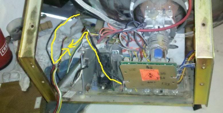

No. You'll blow a fuse on a K7000 either due to a defective part, or by not connecting the wire I mentioned earlier which will cause defective parts...
Modessitt is mentioning the dag wire a few posts back - this is a gound wire that goes from a metal strap around the monitor tube to the neck board. Maybe I missed it, but were you able to confirm that the dag wire is still connected to the neck board?
Is this the wire you're referring to? I have the two ends wire-nutted together along the path that I highlighted in yellow (from the metal strap to the neck board). Is that the right path?
That's the dag wire, alright. As long as it goes straight from the neck board to the ground strap, you're fine with that wire.
