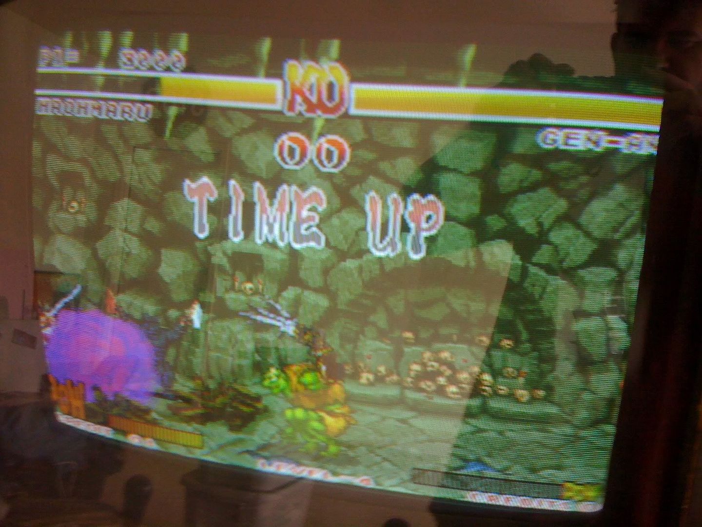

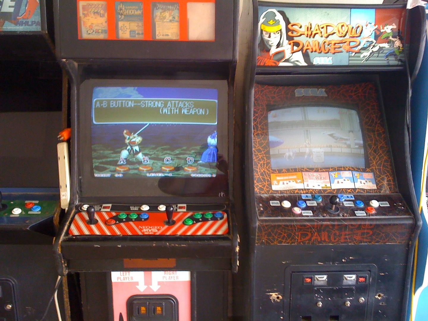

The guy who sold it to me sent me a picture of it working just fine. I'm usually a good judge of character and he truely seems like an honest guy.
