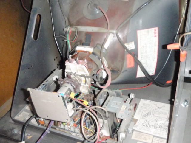

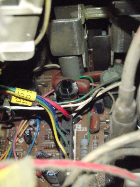

I just picked up a Robtron cab and the horiz width needs to be brought in a bit. I know that I need to use the coil to make this adjustment, by cannot figure out how to do so. It appears that they is a space for a hex key to adjust the tightness of the coil, but none of my key (both standard and metric) will work. Any suggestions?

stop what your doing there, do not use allan keys to adjust a width coil , they sell tv adjusting sets at most crap shacks for under 5 bucks , proper tool for the job. metal keys will heat up quickly due to inductance, you also stand a huge chance of shattering the ferite core
Use the plastic dittle adjustment tools to adjust the width coil. Your hex metal will bust up your ferite core and your picture will probably be bigger. Spray a non conductive spray inside to lubricate the core as over time they can seize up inside.

Got a set of tools today at Radio Shack (on sale for .99 BTW). If I understand the process correctly, I need to insert the coil tool into the center of the coil and rotate clockwise (to decrease the width of the picture). Is this correct. How much torque and turning should this take? I tried a few times and could not see any change in the HzW of the screen. The tool does not turn very easily. Is something wrong?
That center hex piece may be stuck or something. I usually turn it both ways until I see it definitely moving in the direction I want it to move. The adjustment will be very minute at first, so you may have to turn it a bunch to get a noticeable change.
If that doesn't work, you can change a cap on the chassis to decrease the size of the image a little...
So far it won't budge. Any suggestions for lubricant, or is that a bad idea? I also tried to warm up the coil by leaving the machine on for an hour, but no luck.

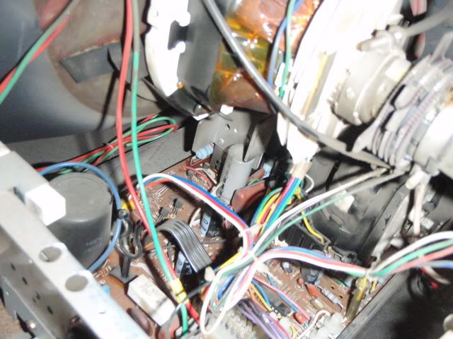

As suggested here and on the NEAC forums, I looked into checking the B+ voltage but cannot located the coil to make that adjustment. Some folks suggested that I have a G07 chassis, but the B+ coil is not in the front left of the board as indicated on Bob Roberts' site. The chassis I have has "ECC 20380" written on it. The HzW coil is black and not white as indicated on BR. I will try again tomorrow. Thanks to everyone for your attempts to help me with this.
Maybe. First, you need to verify your chassis type. Check the pictures here, and see if anything looks familiar:
What's my monitor?
As I mentioned earlier, there is a cap on your chassis that determine the width of your picture. If you can't adjust it in enough with your width coil, then the next step is to change the value of that cap...
If you look at the pots on the edge of the board, you'll notice that two are set a little behind the others and facing up. The one on the left is the B+ adjust.
Make sure - before you mess with it - that you know where to test for your B+ voltage, and what reading you should have...
Well I recapped the entire monitor board but am still having the horiz width issues. I have not tried to adjust the B+, which does not seem to be in the location indicated by moddessit (the horizontal hold is in that area, but no B+). My next step I guess is to try and replace the ferrous coil, which still won't budge. Any additional suggestions would be greatly appreciated.
