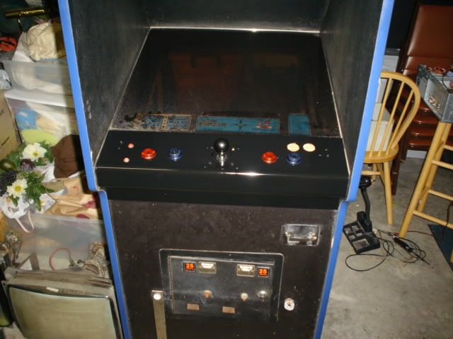

well i need to re do 3 cp's i just picked up but they have some strange joysticks
i have a set of cp's with 4 totlao of these snk football sticks
cant see how they come appart at all
and i hav ethis exidy cab with this joystick on it
That's a monroe stick. Either the black top will unscrew, then you unbolt it from the bottom and remove it, or you push down on that washer on the bottomd and you'll see a c-clip to pop off to pull the joystick top out the top, then remove the base underneath.

i at least got the cp redone on this exidy cab im working on (going to be a 60 in 1 )
before
after
tommorow gotta clean up the front kick , repaint the coin door,and repair the ashtray and paint it up ,mount a monitor and wire in the jamma harness
