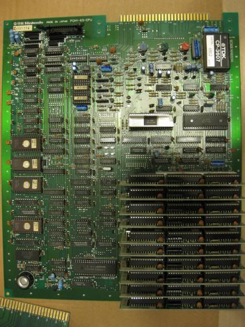

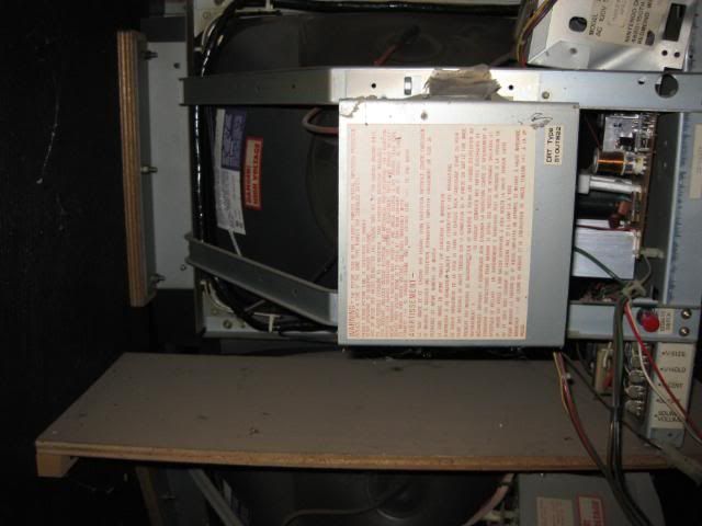

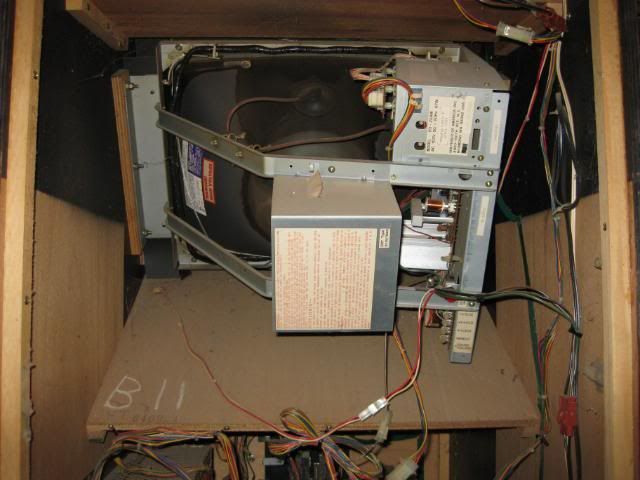

When I turn it on, both monitors light up, but there is no picture or sound. The inside of this thing is really very clean and it doesn't look like anything has been disturbed really, so I feel like it can't be anything major. But like I said, I don't know much about electronic work so what do I know. Here are some general pictures of the internals, any ideas? I can get pictures of anything else needed for a diagnosis. :D
Here's what it looks like currently.

Use a meter and check power going into and out of the power supply (the silver thing on the bottom of picture 1)
Make sure everything is plugged in and secure. All connectors, plugs, etc. Just look it over and make sure everything is connected.

You could also take a look at the PCB and make sure that is connected. Look for missing chips.
Well I cleaned out the cabinet (lots of wasp nests) and checked all the connections. Pulled out the PCB, checked all connections on that. Still no dice. I'll pick up a multimeter today... guess this will be learning experience.

Looks like a power supply issue to me. If it were me, and I knew nothing about electronics, I'd go looking for a working PC-10 Power supply first. If the power supply checks out as working, then I'd move onto the z80 processor chip on the board.
