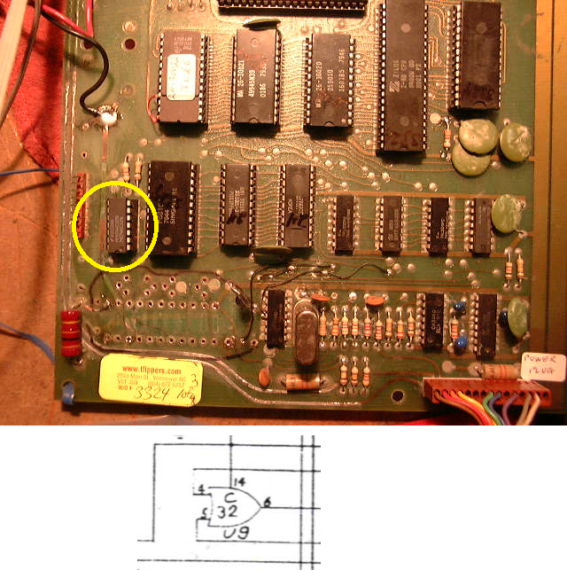

Just got my first pinball machine called Super Nova by Gameplan. I knew when the guy said that it didn't work that it was more than likely due to the battery corrosion associated with these machines, but for the price I couldn't pass it up.
Luckily, the battery damage isn't near as bad as I thought it would be and only one chip has corroded. I need to know what this chip is because the labels on it are no longer visible on mine.
Here is a picture (from flippers.com) and the chip circled in yellow, as well as the schematic drawing of it.
http://i107.photobucket.com/albums/m287/twanger929/MPU2.png

What Lindsey said; the GamePlan repair guide lists it as either a 74LS32, or a 74C32 - position U9 on the MPU-2 board. Also see pictures showing a 7432, so any of the three appears to be proper.
That's it! I was having one of those stupid moments when I tried to search LS7432 and C7432. No wonder I wasn't finding anything on it. That and I should've known that the random line at the top was power since it's pin 14.
Looking at the datasheet, it is identical to a 74LS32 as far as the pinout goes. Only difference is that the C32 can take higher voltages, which is probably why it's on there instead of just another 74LS32. Found a semi-replacement that's available (pins don't match up), CD4071, and with a little re-wiring it should work fine.
