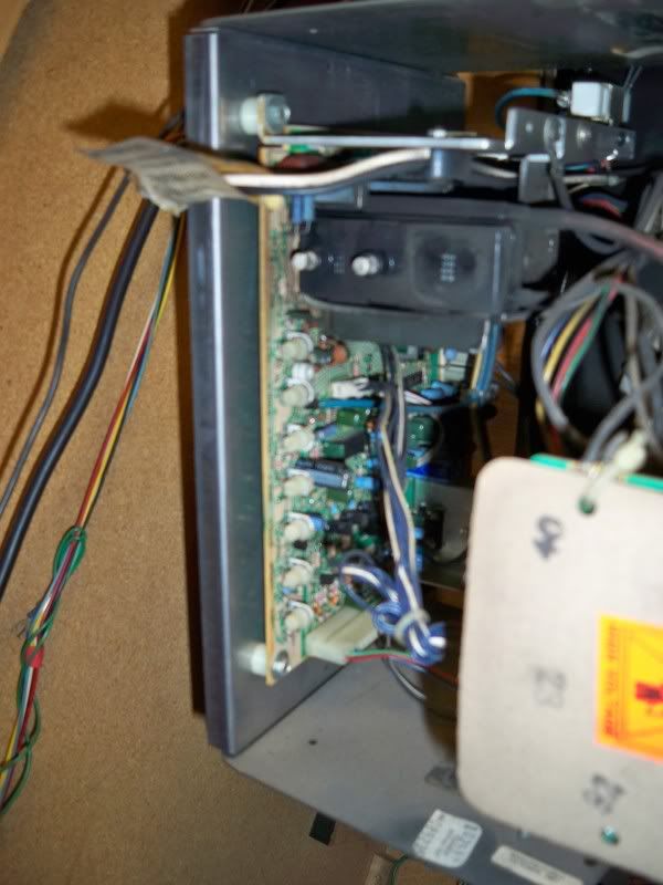

I just purchased a Guerilla War machine and I am finally building my Mame after 10 years of wanting one. All works great with my J-pac. Except the monitor has a vertical wiggle that is not too bad, but it is still driving me nuts.
I have adjusted all the pots and have the picture near perfect. I just can't seem to get this wiggle out.. I am using a Nvidia Avanta video card using Soft15 with my J-pac usb.. Any and all help is greatly appreciated. Need to know what chassis this is and what I may or may not be able to do to fix the wiggle...
I have several stickers with numbers and 2 that are the same with the numbers WG 086235, But when I search nothing comes up for this...

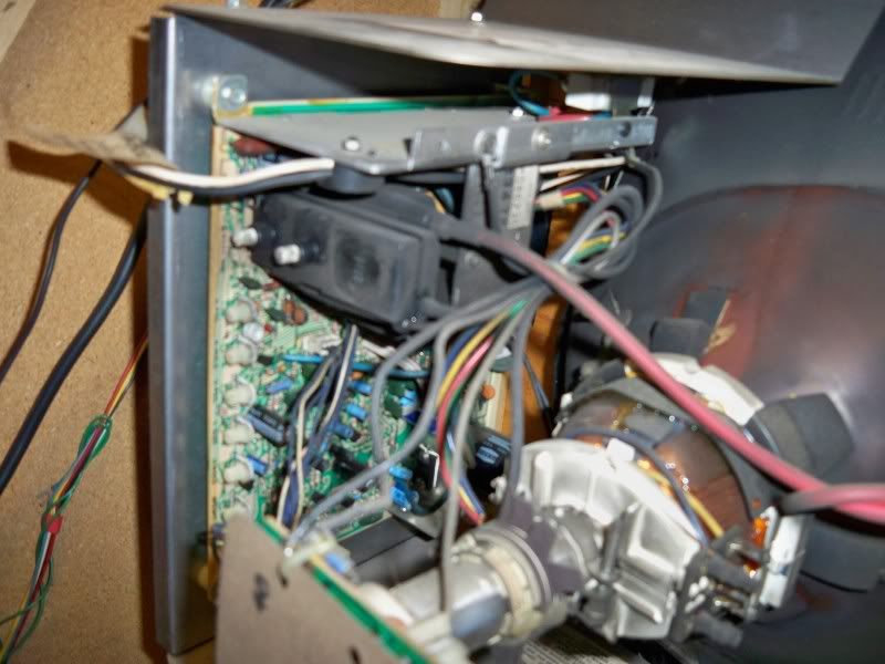

looks like a k7000
looks like a k7000 with a wite nob flybac witch may need replaced if cracked

Thank You. How would I find out if it is cracked? Where and what do I look at? Sorry I am a total noob. But handy with electronics..
first where are you located.
clean it off with a brush or somthing if its real dusty or whatever and visually look at it all over to see if its cracked thats the only real way unless you take it off and look at it.

I played around with it for a bit.. I did not see any cracks, it makes no noises and has a great picture..
I decided to try and change the screen settings and see if that had any effect. And it did, everything was too large for the screen.. But it did not flicker/wiggle anymore..
I am wondering if maybe it is my video cards? Originally had the Avanta card in and now I tried an older Jaton with Nvidia 3dforce..
I changed the resolution again to check that the screen was still.. and it was. the picture is perfectly still at 640x280 but I cannot play at this resolution. even the Mala splash screen is off the screen..
