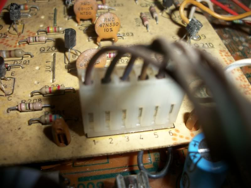

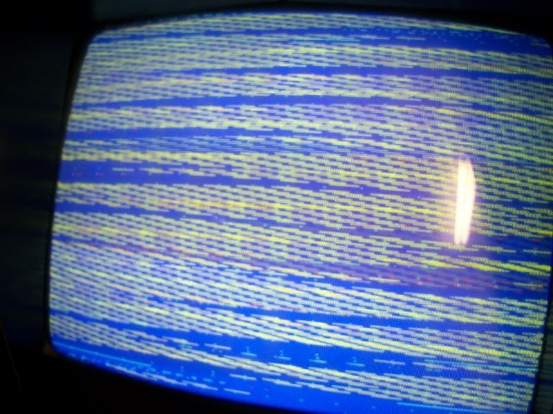

Ok guys i hope someone can help me out here. Im still a bit of a newb but i just rebuild my G07 in my TARG. (new flyback,all caps, hot, regulator) Well when i hooked it back up i was getting horrible scrambled images. So i thought i had a chassis problem so i sent it out for repairs. Well i get it back when its supposed to be working 100 percent and im getting the same problem i had before so i now believe i defintly have a sync problem.

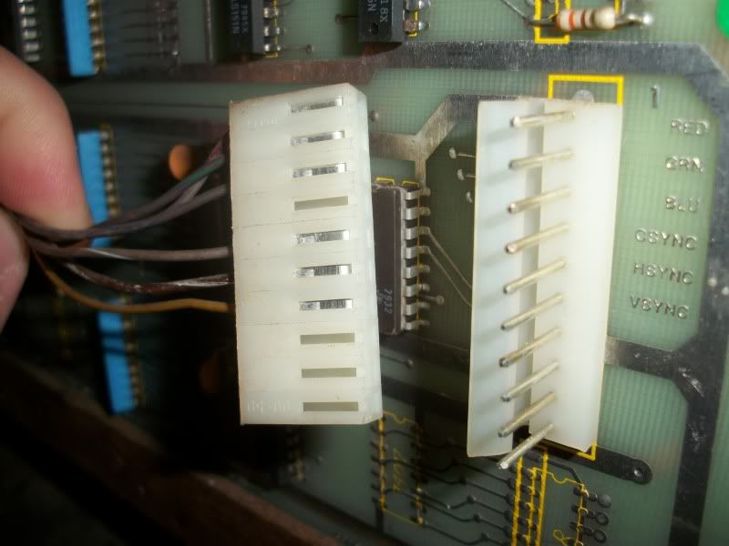

After checking out the setup on my TARG machine it looks like the red green blue sync etc. all comes from the little board below the PCB. And i took some pictures of the way it is currently hooked up. One thing i noticed is the where the pins are labeled on the board it looks like on the connector someone skipped the wire that says C sync and dropped the wires down a slot which (to me) looks like the bottom one isnt making contact with the labeled pin on the board.
So couple questions here, does anyone see anything wrong here, and anyone have an idea of where each wire goes to the 6 pins that are on the video board on the G07 CAO chassis. Thanks!
Below are Pics of the way it is currently hooked up, also a pic of the 6 pins on the video board on the chassis 1-6 (unfortunately none of the wires are really colored either.) And also i included a pic of what my screen looks like. i can never get it to stop scrambling much.

ok thats good info. but judging from the first picture does it look to you like the pins in the connector are connecting to the h sync and v sync correctly? To mke it looks like they skipped the c sync and then moved the three wires down.?
Definitely missing a ground pin...
Its going to be either set of these
R G B HS VS GND
or
R G B CS GND

It looks like a simple adjustment which is common after a cap kit. I think your plug looks good, you have RGB hsync vsync and ground all present.

I'm not sure on that version... on mine, looking at the connector from right to left its R G B G VS+ HS+ and there is a separate one for VS- and HS-
So my guess is:
1 = RED, 2 = GRN, 3 = BLU, 4 = GND, 5 = VS+, 6 = HS+
On your board its clearly labeled except for the GND pin which I would suspect is pin 7.
Monitor Pin 1 > Targ Pin 1 (R)
Monitor Pin 2 > Targ Pin 2 (G)
Monitor Pin 3 > Targ Pin 3 (B)
Monitor Pin 4 > Targ Pin 7 (GND)
Monitor Pin 5 > Targ Pin 5 (VS+)
Monitor Pin 6 > Targ Pin 6 (HS+)
I'm probably screwing this up...
ok got the CAO manual and yead its rd, gr, blu, grd, v sync, and h sync (left to right)

All im getting is these crazy scrambled images and the picture will never settle down no matter what i adjust?
This is a G07-CAO that was sent to me non-working. The B+ voltage was reading ~150VDC. Replaced the voltage regulator and the HOT blew. Replaced that and I had had stable voltage, but no heater/picture. After a couple minutes, it fired up, but with an out-of sync picture.
Figuring some kind of thermal fault due to a broken solder joint, I sat down and touched up every solder joint on the board (there were about ten million broken joints on the board) and I got a good image - but one that just wouldn't lock on. Suspecting a problem with my test rig, I did connect a wire bridging the H and V syncs together on the bottom of the interface board (you can see the black loop of wire in that first photo of the chassis) and it snapped to a perfect picture.

In those photos above I'm not seeing a video ground, unless I'm mistaking it for something else. I see R, G, B, C sync, H sync and V sync.
edit: looked over the image again, and yes, there is a video ground.

ive tried adjusting the H freq pot and it never stops going nuts. It actually looks exactly like that video on youtube of someone's Frogger that was going nuts on the screen. Anyone see that?? Looks just like that.

Discharged the monitor, unhooked it, pulled the chassis and found the black wire loop mod peale did. (the wire that was connecting the h sync and v sync (pins 5 and 6) Cut it, put it back in and within 1 minute of adjusting BOOM picture locked right in looks great, and i then spent the rest of the afternoon rocking out on spectar! YAY!!!!!!!!!!!!!!!!!!!!!!!!!!!!!!!!!!!!!!!!!!!!!!!!!!!!!!!!!!!!!!!!!!!!!!!!!!!!!!!!!!!!!!!
