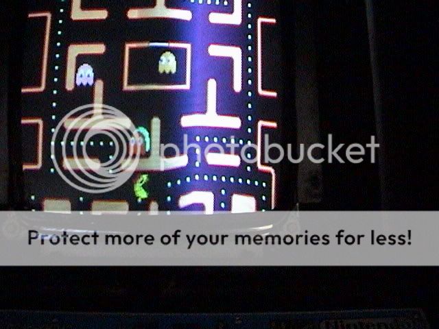

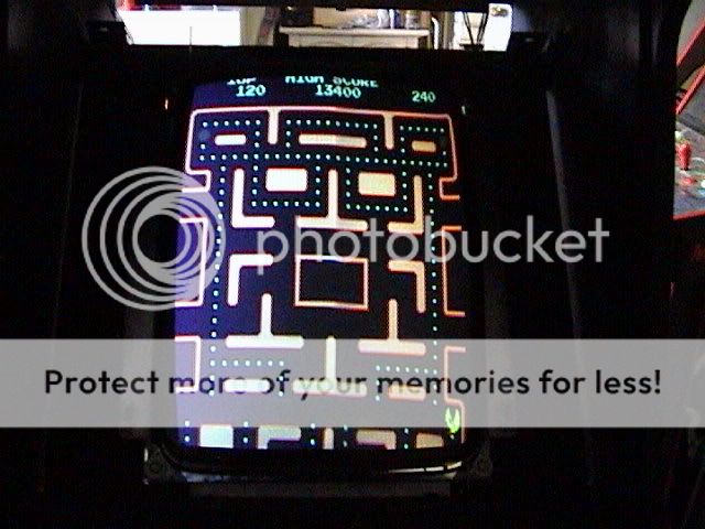

Ok heres the deal,
i just bought new 19" Monitor (not sure what the model is) that i am installing in my 60-in-1 Muti-cab. but when i go to hook it up the monitor chassis has a 120 plug in for a wall socket when the other monitor i pull out of the machine didn't. so i think i need to wire it in some how to the power supply? not sure though.
Side Note: there are some other problem when i just plug the monitor into the wall and turn the machine on there is a kind of pluse or small wave that goes threw the monitor but i think thats a voltage problem due to it being plug stright into the wall. and some of the bottom screen is getting cut off i have tried adjusting all the pots on the chassis and does not seem to change any position of the screen just color . but i dont really want to address these problems until i get the monitor wired right.
PS: here are some pics there not good but i can take better one if needed.
http://i698.photobucket.com/albums/vv344/Liu_Kang_MK1/DSC00561.jpg

The picture of your chassis shows that it requires an isolation transformer to run it properly. By running it without one (you plugged into a wall outlet, a big no-no) you have damaged it.
monitor
Put the isolation on and see if the problem still is there. usually when people do this it takes out the bridge diodes or,regulator,output,flyback.
I am guessing that your regulator is passing a.c. into the d.c. section.
