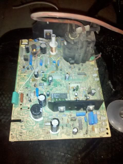

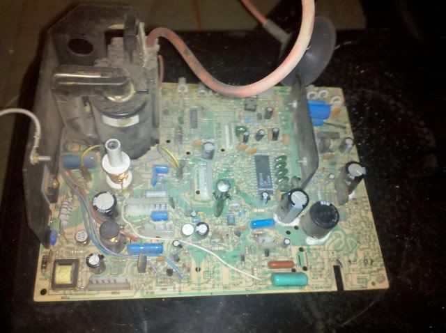

So I THOUGHT this is a k8000...but now Im not so sure.
It is out of a Virtual World 3.0 Cockpit, and I am trying to figure out what the hell kind of video signal the game outputs. I figured a posative ID on the monitor chassis would get me most of the way there.

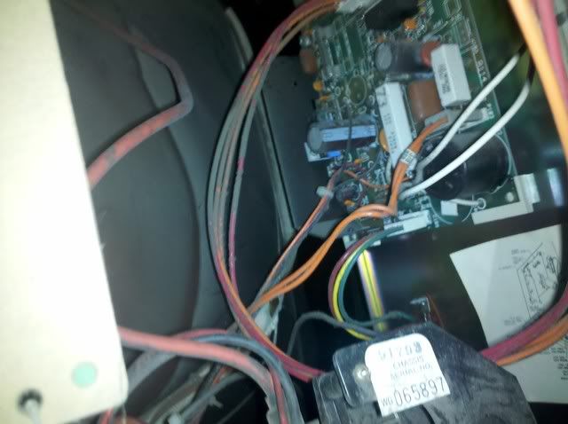

Secondary Power Board

That is a Wells K8000. One of those stickers on the right side looking at it from the back should have the model number on it. There's a U3000 chassis that's similar but it has more parts and is VGA.
If thats the factory monitor for the game the video output should be medium aka EGA resolution.

your K8000 looks entirely different from mine. probably cause mine's the 33" model, there's more adjustment pots in the empty corner on yours, and more caps. goes to show Wells and their stupid number assignment is.. stupid?
