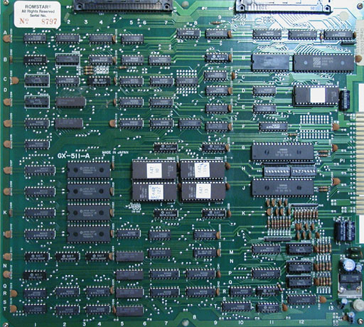

need help identifying this PCB
tddlny
Feb 22, 2008
642
19
Plainfield, Indiana
Any help would be appreciated. It has 14 e-proms labeled S-1 thru S-14. Also labeled MITSUBUSHI ELECTRONICS. it is a 2 board set attached together by 2 ribbon cables. It is not a JAMMA board so I could not test it in one of my other games.
Any help would be appreciated....
See the pictures:
might be but I don't think so. Tiger-Heli eproms are labeled with A47 stickers according to a website I found. Anybody else?
The easy way to ID a board is to read the EPROM in a programmer, save the image to your hard drive, and run ROMIDENT against it.
ROMIDENT will tell you what it is *if* the checksum is in its database. If it's not, then take the checksum it gives you and run it through Google to find the game in the MAME archives.
