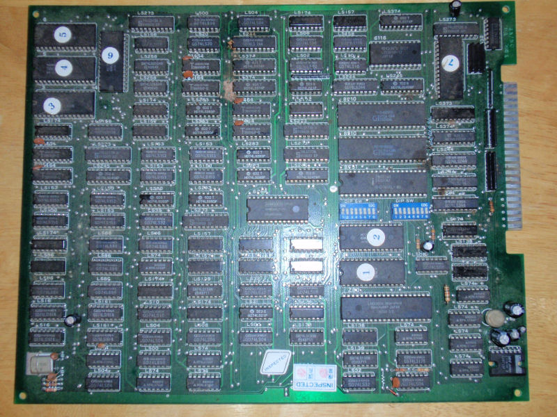

I got this board from an old operator, and it was wrapped up with a Super Qix marquee. I can't find any markings on the PCB, other than someone had etched with a knife or something sharp "Super Qix" on the board, nothing official looking. I looked it up and Super Qix is supposed to be jamma and not a taito pinout. This definitely is not a jamma pinout, so what board is this? Is it possibly a bootleg or some other board? What would the pinout be to hook it up if it was a bootleg? Any help would be appreciated.
That's definitely a bootleg, and yes there's a non-Jamma SQ around, I have the pinout at home, I can post it later if no one has it at hand.
Dang, it's in german, I had to make some translations first :rolleyes:
I gave this pinout to someone before, and I think something was reversed, but I'm not quite sure anymore, could have been because he wrote it down on paper (my printer didn't work then...). Nothing major, just one of the colors...? Hope it helps anyway... :eek:

Very awesome, thank you! Thats why I love being on these boards, sharing obscure 25 year old information you can't find anywhere anymore.
you sure it's not jamma and just doesn't have the key slot cut in the connector? I had a PCB like that once and dremeled the notch
