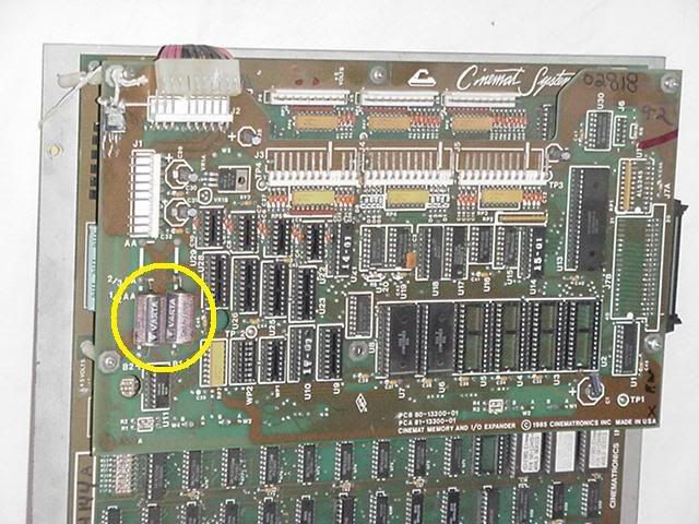

Hello all...I've recently began my childhood dream to have my own arcade in my house. I just bought my first game...World Series The Season. What I'm trying to figure out is how to get them memory to work or how to add memory to it. When I played this game in the late 80's, it kept your stats based on the username, birthdate, etc that you entered.
So....how do I do this?

memory is either kept by NVRAM or a battery. I'd check for a battery first...
Forgive me, but I'm brand new at this....can you expand on your suggestion? What kind/where would I look for a battery? And what is NVRAM?
Thanks for being patient!
sv
RAM is memory that saves info, like what your score currently is. However, it only works while the power is on, which they call "volatile".
NVRAM is Non-Volatile RAM, which means it remembers the info even with the power off.
It is not likely that your game will have NVRAM unless someone went in after the fact.
As for a battery, it could look like a regular AA battery (or a couple of them) in a holder, one that is soldered on, one that is round like a watch battery, a short one like a camera battery, etc.
Look at your circuit board. You'll see two 3V batteries as circled in the picture below. If you know how, you can measure them to see if they measure 3Vdc. Most likely they are dead. If you can solder, you can take them off and take them to a Batteries Plus or similar store to buy some new ones exactly like those...
