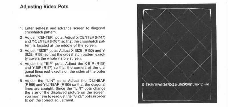

I feel like I am pretty close to having my 6100 dialed in but I just can't seem to get the diagonal lines to get inside that box.
I read the FAQ/GUIDE for the monitor and the manual. I am not getting it. But, I am close.
Any tips? Here are some photos:

Are you adjusting the pots on the game PCB? Usually, you adjust them all to get the most corners touching the outside border and filling the screen, then go into game play to make sure all the vectors are touching where they should, making adjustments as necessary.
I'm not sure I've EVER seen a 6100 where all the corners touch perfectly after adjustment...

Yes, I am adjusting the pots on the PCB, other than color, that's the only place to adjust them! I have a bunch of things that are not lined up right in the game. It's playable, but looks odd at times.
Any ideas how to fine tune my display?

On my Tempest, I got the crosshatch screen to look similar to what you have there. to get the vectors to line up right, I used the 3rd screen in the test sequence to adjust the bipolar pots. Once the edges of the outer rectangle on the test screen lined up, it was all set. I think I need to work on the centering some more, but the vectors line up great now.

Pcolson is correct and he is referring to self-test screen 4. Check out the video I made of the self-test screens on my Gravitar.
http://www.youtube.com/watch?v=pLUxxRknbG0
Screen 4 is displayed about :35 seconds. You will notice that the block in the middle of screen 4 forms a perfect rectangle. If yours forms a parallelogram use the bip pots to adjust until a rectangle is formed. Let us know if this helps.

Yes, mine is not a rectangle on that screen. That's the raster screen, right? The manual said this was for the factory and not for me. :)

You are correct. The Operator's manual states exactly that, but read page 16 of the schematic package. See attached.

Ah, good call! I am gonna wait for a friend to come over and have him be my eyes in front of the machine and make those adjustments. I really wish there was a remote board!
