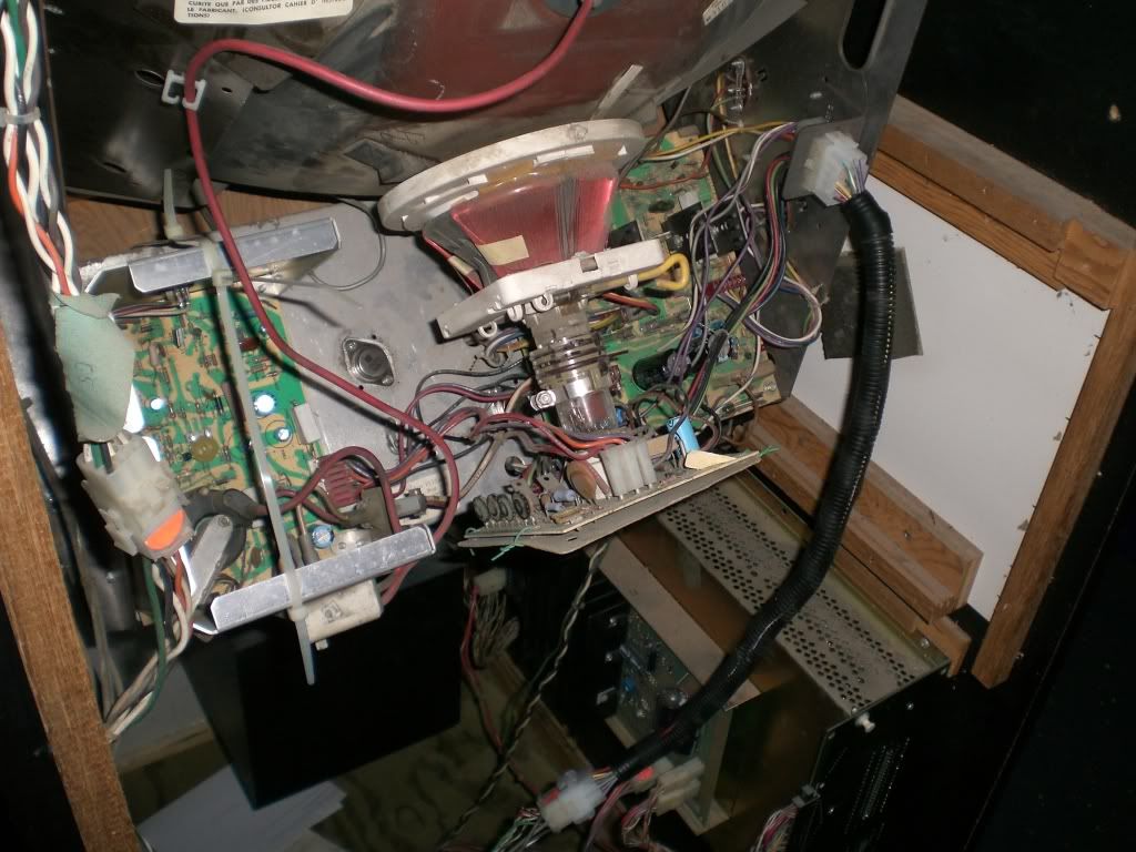

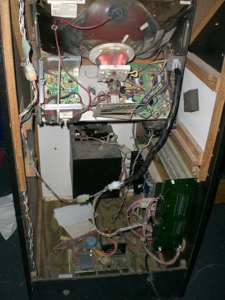

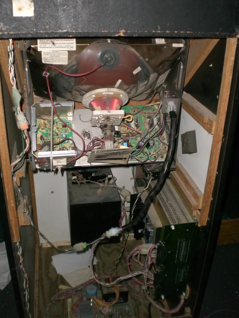

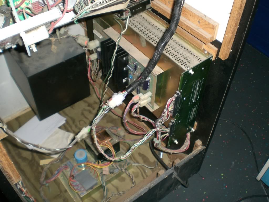

When I purchased my sw ur it was in pieces. I do not know how everything goes back together.. :/ does anyone have any pics to show how the pcb...power supply and chassis is to be hooked up? Any pics would help. Right now I am waiting for chassis to be returned...but I am able to connect the pcb and power supply up. Please help! Coin door I already have connected...
I have a wells gardner....don't have a manual yet....gonna have to rely on pics for now. Don't need pics of monitor yet....just how pcb and power supply are hooked up.
I'm going to be installing my new ESB kit in mine soon, so I can snap some pics for you if there aren't any on this thread by then.
got manual...but my sw has a wg6100. anyone got pics of theres installed in a sw? any help appreciated. should be getting chassis back tomorrow or fri...wanna get it up and running this weekend. i got the pcb hooked up...just need to know how to correctly connect the chassis to the rest of machine. thanks!
Hooking up your 6100 should be very easy. Here's some pics of the inside of my SW upright. Sorry for the clutter, it's not been restored yet.
FYI, there's a 6100 extension cable installed in these pics...it's the cable that's wrapped in sheathing.
Thank I very much! The pics will be very helpful. Much easier when I can "see" where its supposed to go. Will keep posted on results!
Got chassis back today. Everything else was hooked up..used pics to help....flipped on switch and it works! Thanks again for the pics!!
