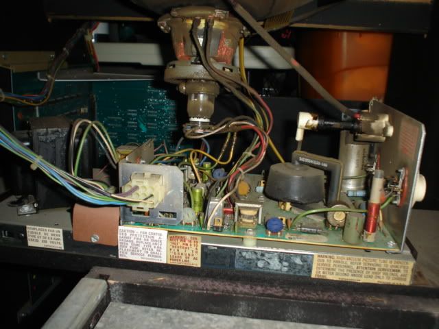

as the title says i need a list of all the caps needed for a midway si dx upright
i have no markings on the chassis tha saythe type of monitor but i am positive i still have the original going down to pick up a huge lot of caps so id like to get this monitor taken care of finaly
hmmm damn nope thanks for the link
any ideas on model # for the old b@w's
here is the one in my game all i see for id markings is a midway serial sticker on the chassis
cool that looks like it thanks
i usually do use bobs id page but i had no idea where to start looking on this one other wise id have to have looked at all of the pics
again thanks now to fix this biatch
edit screw it ill just order from bob less hassle than tracking down a cap list lol
If still needed...here you go...
Motorola M5000/M7000/KV-700 19"/23"
1uf16V C15
4.7uf100V C44 Axial
22uf25V C3/C4 Both Axial Caps
47uf50V C1 Axial
100uf10V C47
100uf63V C40 Axial
150uf10V C23 Axial
C32A/B/C/D 20uf200V/400uf125V/600uf100V/200uf50V
