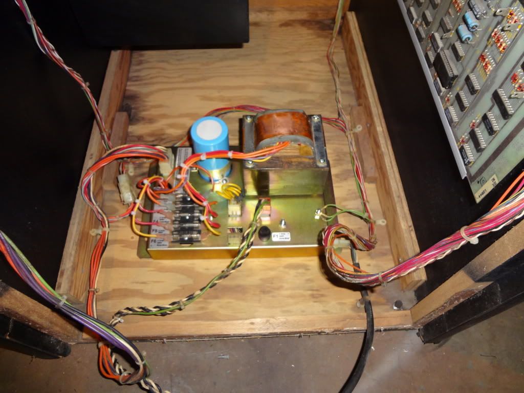

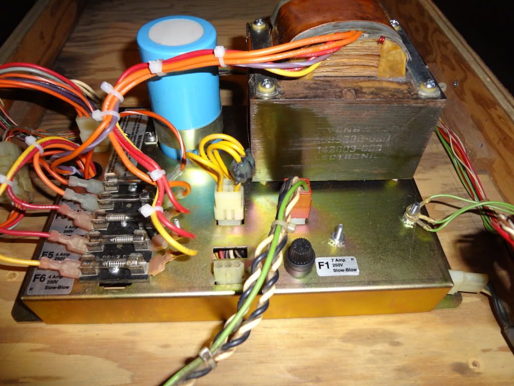

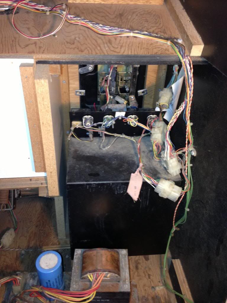

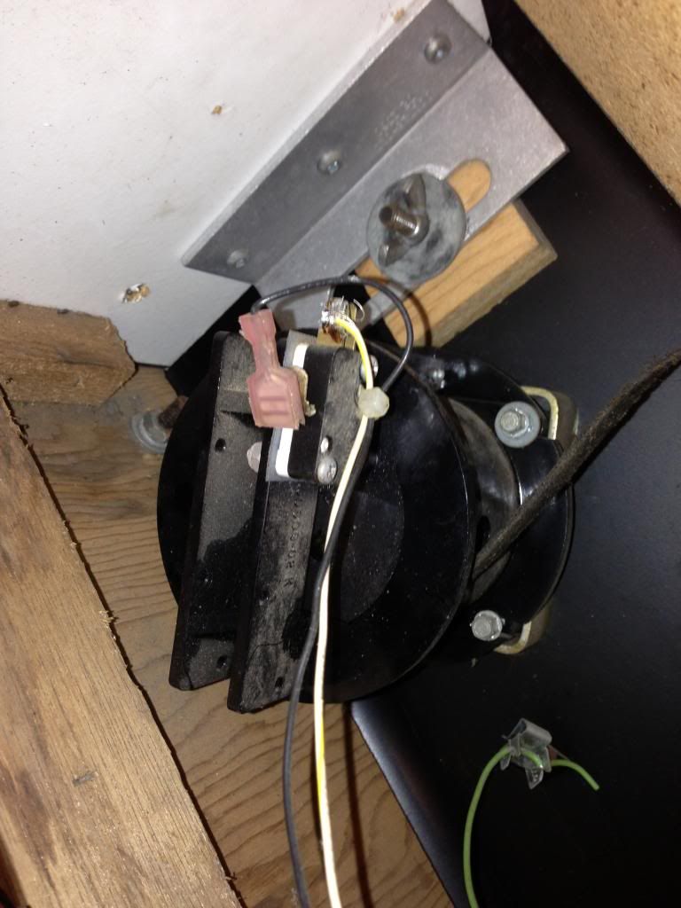

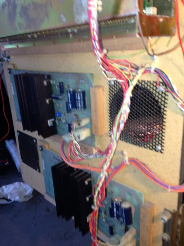

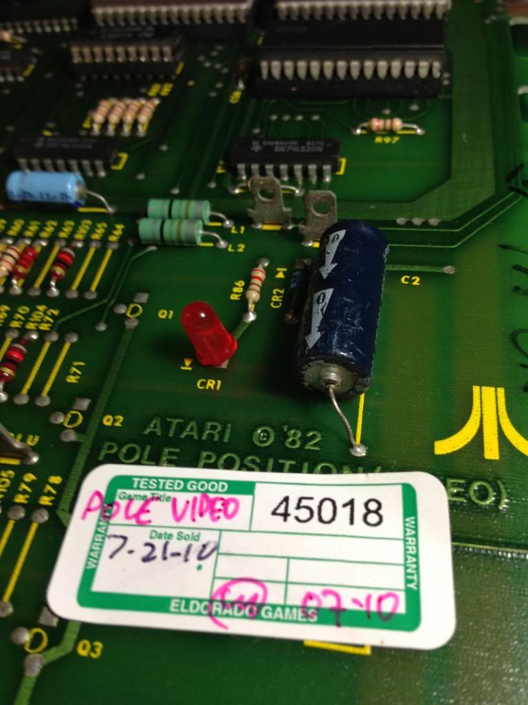

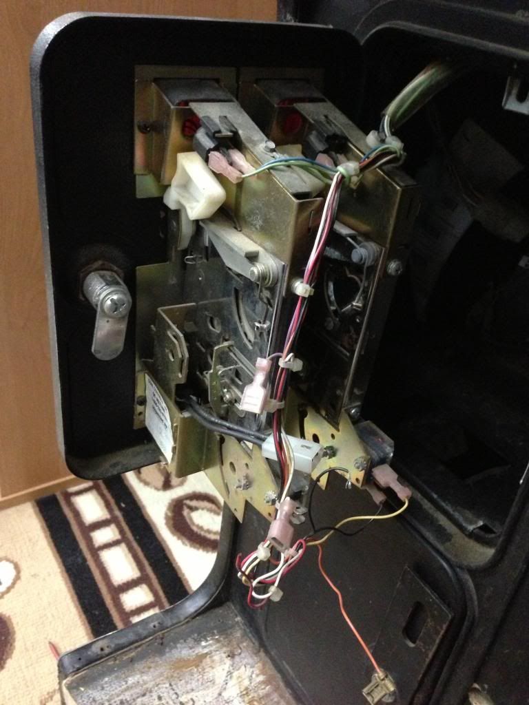

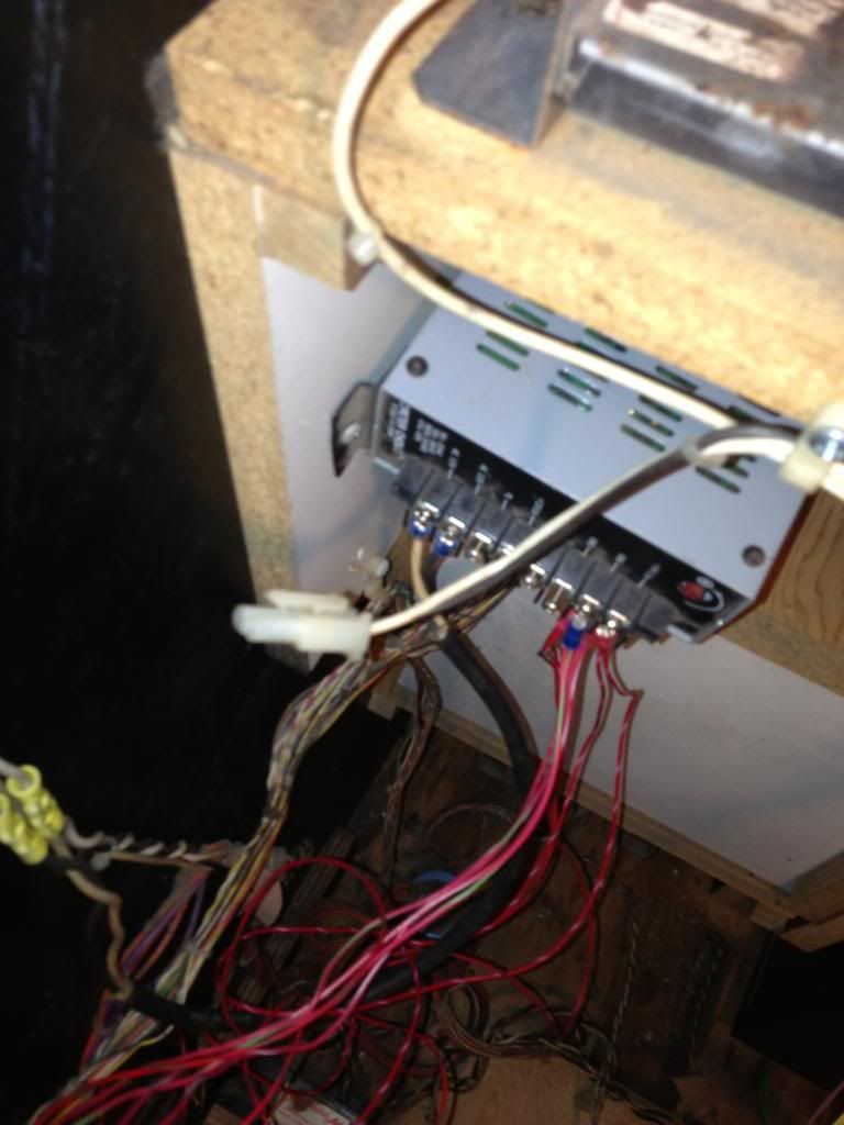

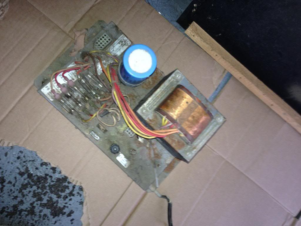

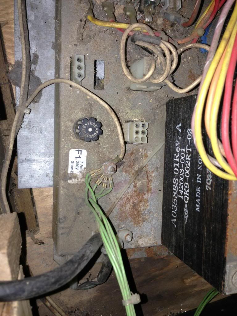

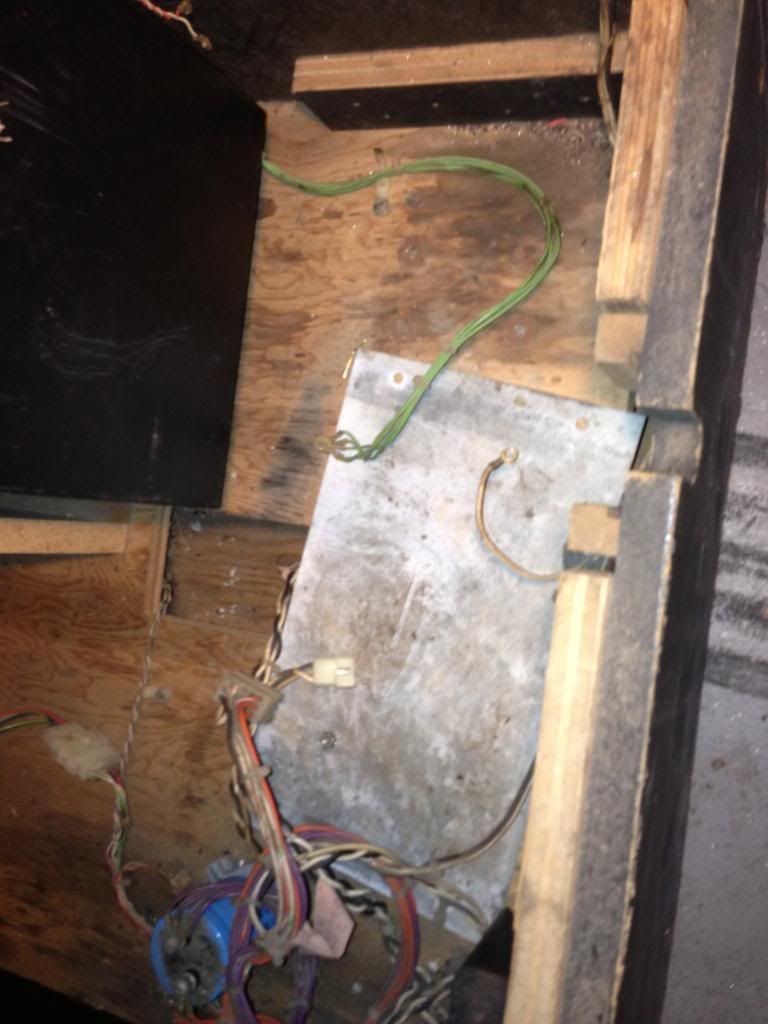

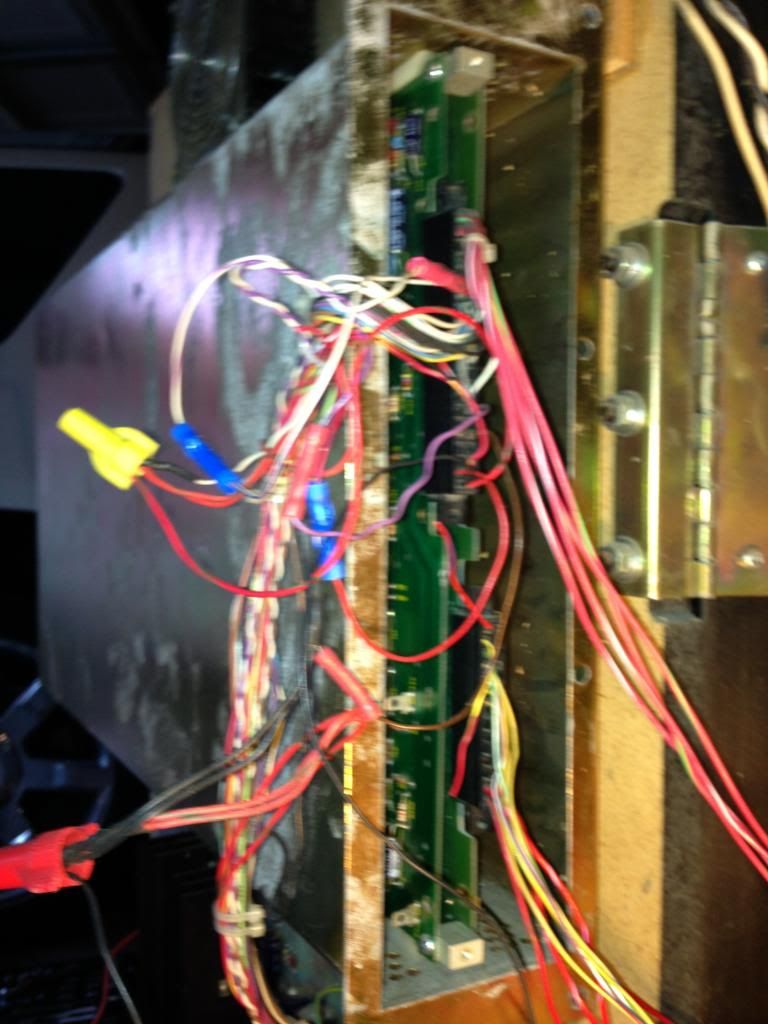

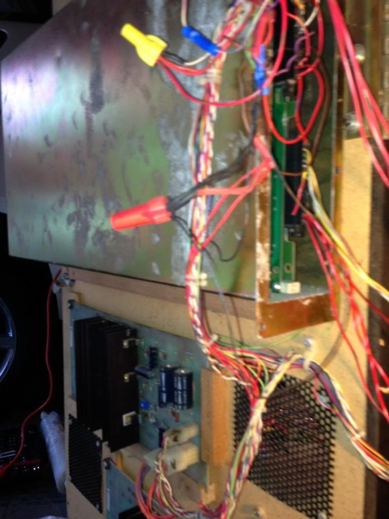

Hey everyone,hope all is well. I recently acquired a Pole Position 2 Cockpit, and had to gutted out everything to bring it into my basement. I got it in working condition,but before I put it back together, I was wondering what should I change or clean on all of the electronics. Thanks to Scottmaggie, he mentioned Bob Roberts for parts and looks like a lot of mods were done to the cabinet. I have lots of pics. Any help would be greatly appreciated,thank you

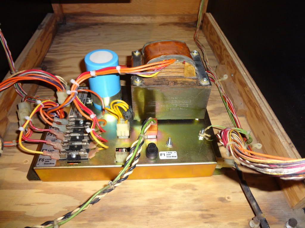

You need to disassemble and clean the shit out of that power transformer block. Most parts should be replaced, like the fuse holder, fuses, big blue cap, crimp connectors, etc. (you should grab 2 big blues, as there is another one mounted to the floor in the 'engine' compartment). Should look more like this when you're done:
Wow, Phetish. You can actually eat off of that,wow that looks good. I have a lot of work ahead of me. I guess you wire brush everything out ? I did send an email to Bob regarding parts. Too bad I cant get anything local
