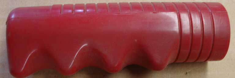

If anyone needs the red grip for the joystick they should act fast as pbresource.com has NOS grips for $8 each :eek:! About two thirds of the way down on this page.
