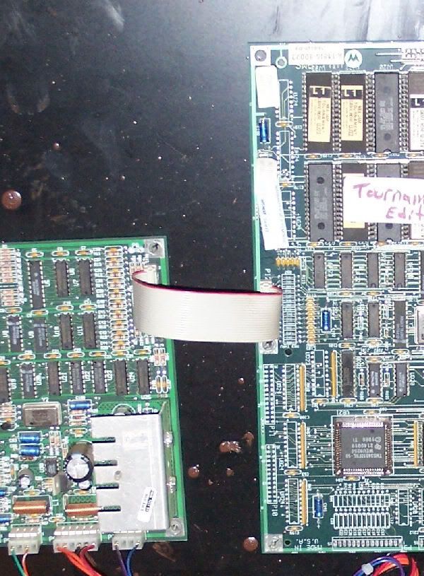

lets see the sound board connection also.

got a few more pictures. I noticed that one of the red lights on the main board is out. Could this be an indicator of the problem?

looks like your ribbon cable is backwards on the sound card side of the cable. tough to tell from your pics. the side of the cable with the red trace should be on pin 1 of both boards.
alpha-tron could be the big winner on this one :D
it should look like this:

Resistance can come from bad cables. I just fixed a friends NBA JAM. It had a Crystal issue and a static noise issues that went away when the ribbon cable was replaced.
The more I study your cable. I agree both sides are reversed.
