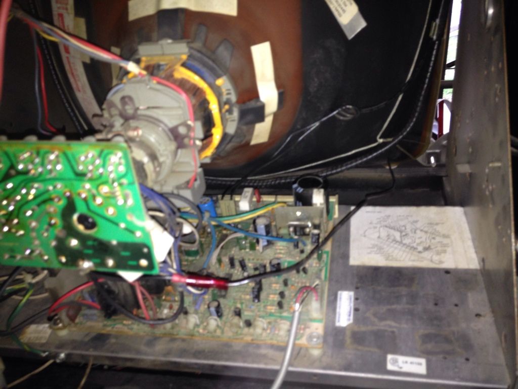

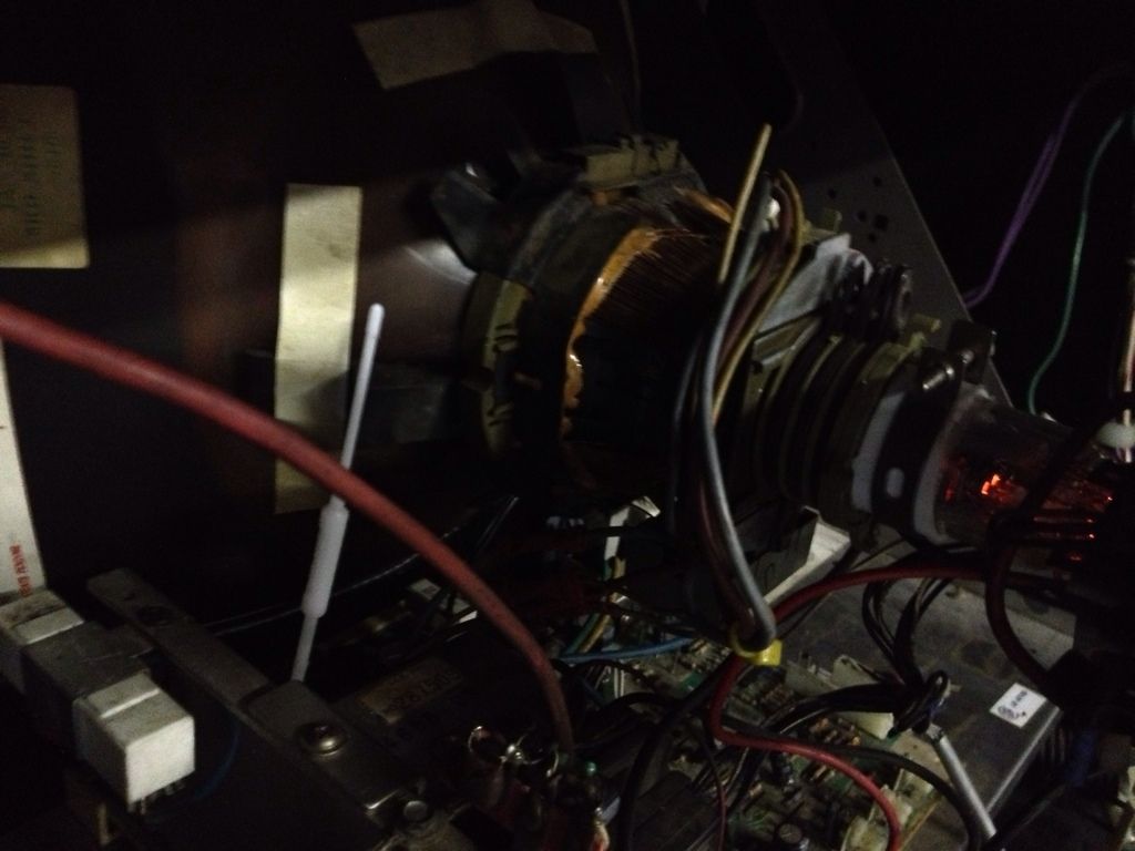

So I picked up a Narc to help RenegadeFred out and I knew going in the monitor (K7000) was an issue (no green). Threw the tube on the rejuvenator and no dice (no green emission at all) so I started looking through a few Discarded TVs I've collected over the past year. I pulled one down and the yolk resistances were off but not by much.
The yolk that was on the tube in it had
horiz res - .8 ohms
vert res - 8.8 ohms
The tv I had -
horiz res - 3 ohms
vert res - 9 ohms
So I decided to be better safe than sorry and that I'd need to transplant yolks. Unfortunately the thing was so dry rotted it crumbled as I was taking it off of the tube and now makes a great paper weight.
Since I read that sometimes the resistances can be close I decided to use the yolk from the TV and it's pretty close.

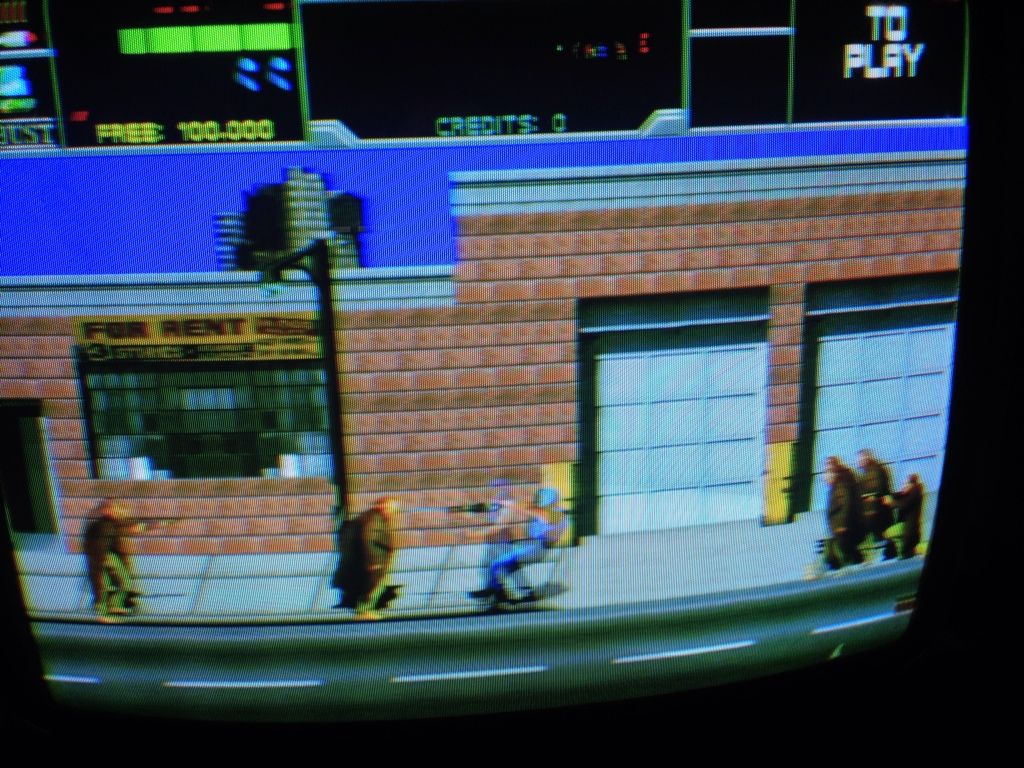

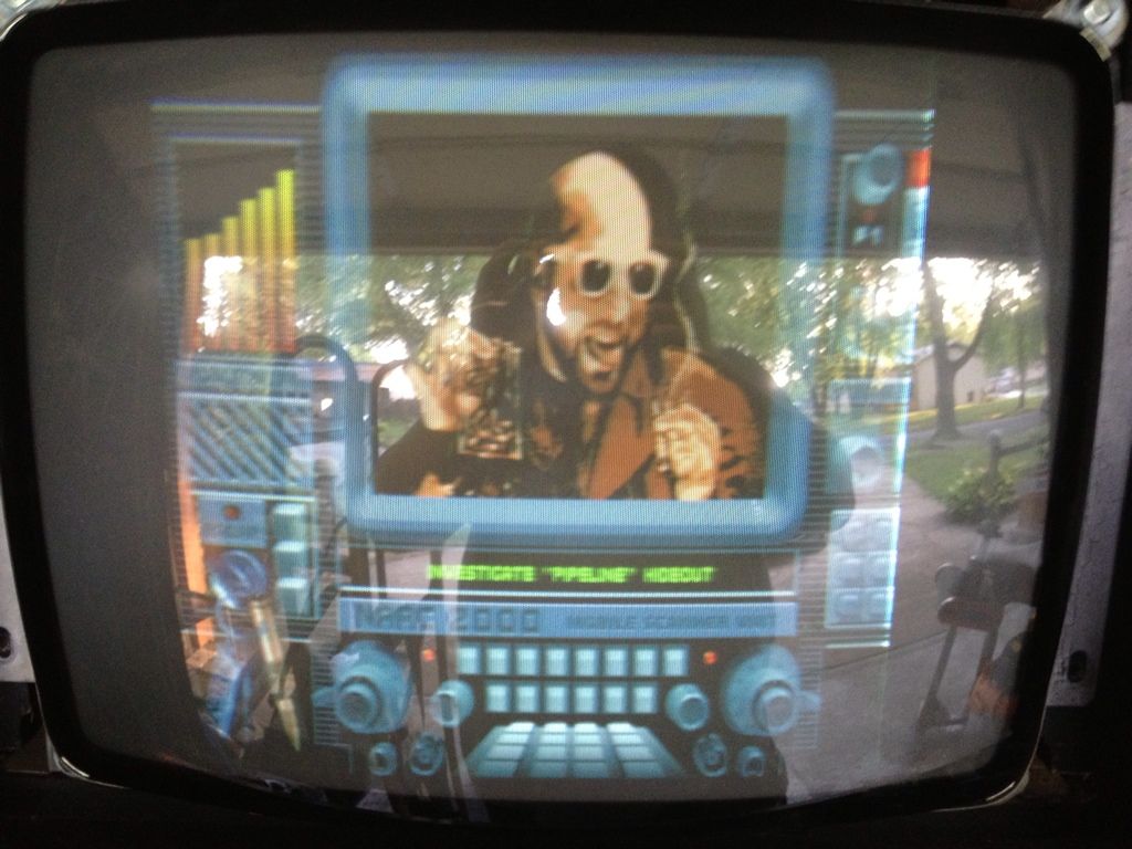

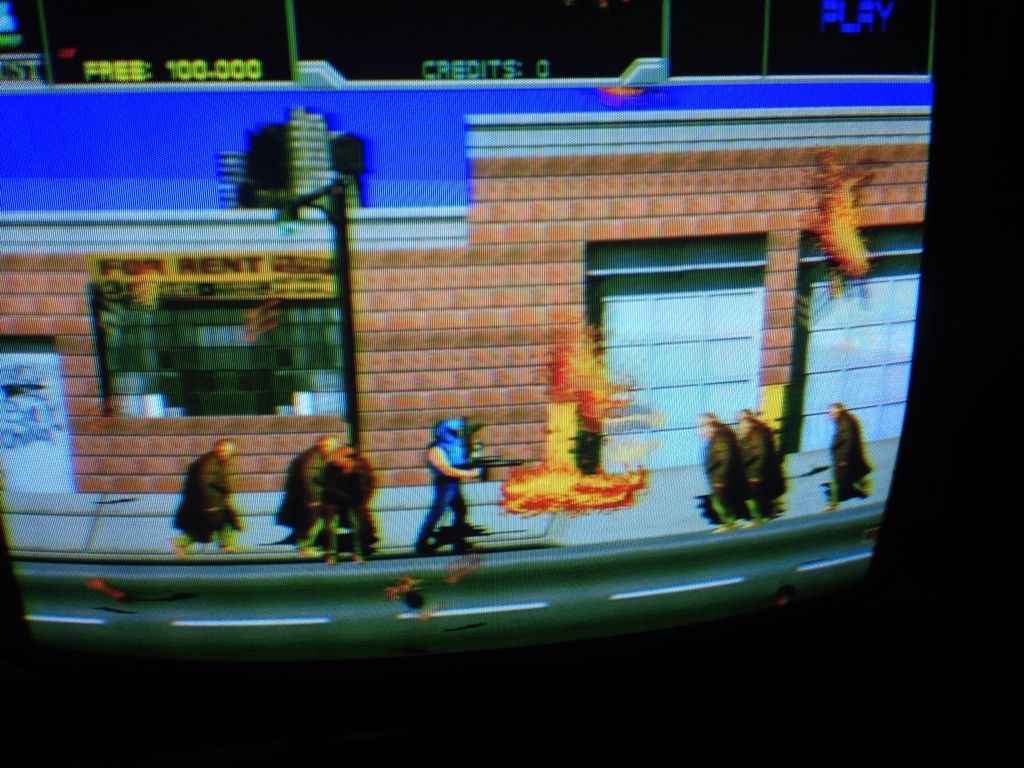

There's some horizontal curl over on the right side of the screen. I've tried adjusting the width coil but was wondering if there's something you monitor gurus can tell me. Maybe by swapping out some components on the horiz deflection circuit or changing the width coil. Not sure. If not does anyone have a comparable yolk to sell?
Cheers,
-M

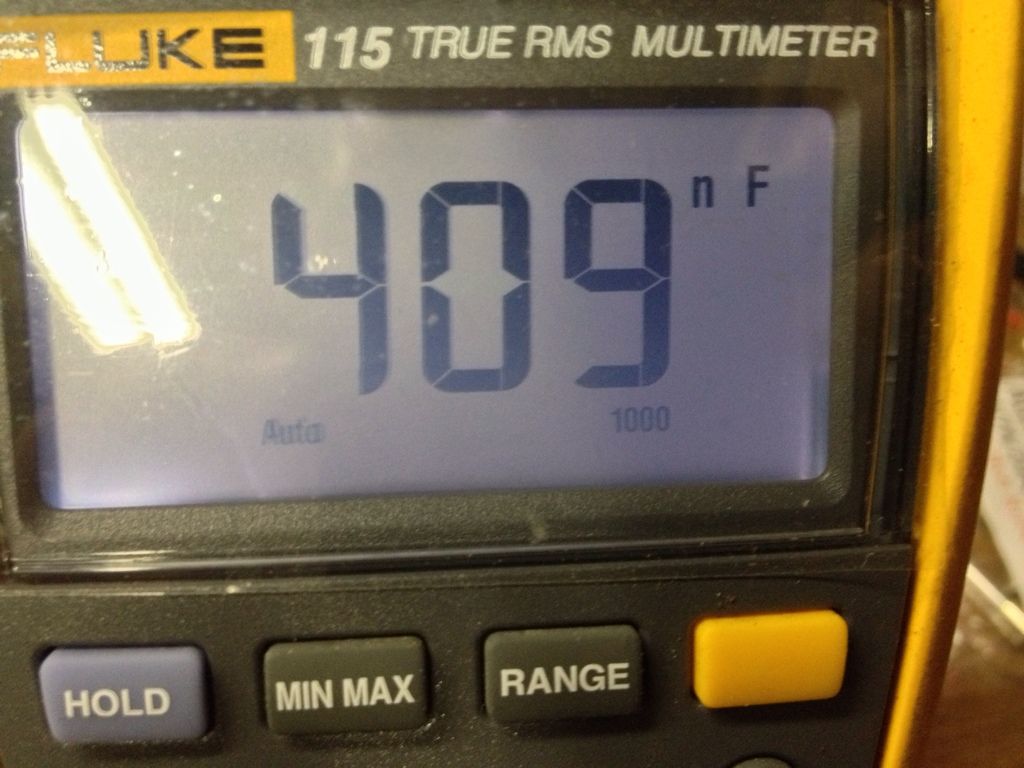

So I went ahead and ordered Bobs width kit and remove the width bag cap on my k7000. It was pretty corroded so I put it on my meter and read 409k nf so the next smaller size was 227k nf and I put that in and there's no real difference to what I had and the width coil can't be adjusted now.
Should I go smaller/bigger or am I barking up the wrong tree and need to buy another yolk?

Tube 'a48acb02x', manufactured in 1989 the horiz resistance is about 2 ohms off which is probably why the screen is horizontally short.

I think you have it backwards. The higher resistance of your horizontal winding coil implies it has more turns in the coil than the original yoke. More turns make a higher magnetic field for a given current; more magnetic field makes the beam deflect more. A yoke with an overwound horizontal coil would give a picture that was stretched, not compressed, horizontally.
Also, an over- or under-wound coil would stretch or compress the whole picture along the horizontal axis, instead of displaying correctly near the center but stopping very suddenly at the edge.
For some reason your horizontal deflection circuit isn't making it to the peak positive and negative voltages it's supposed to reach -- the waveform is flattening out short of the peak voltages, so the beam can't deflect all the way to the left or right edge of the screen. The problem could lie in any of the components in the horizontal deflection circuit, or, since that circuit is driven by the B+ voltage, you may have a fault in the power supply circuit that's causing B+ to be too low.
The higher impedance of the coil means more voltage is needed to reach full deflection. A 3 ohm winding is absolutely NOT a suitable replacement for 0.8 ohms.
The picture would be back-to-front if that was the case.
Hmm.. So is there a way to increase the voltage of the horizontal deflection circuit?
Slight correction: it's current, not voltage, that creates the magnetic field that deflects the beam. The voltage helps you push current through the coil, but the electrons in the beam don't know and don't care what voltage is driving the current. All they "see" is the magnetic field generated by current flowing through the coil.
I agree that the problem lies in using a 3-ohm coil in a circuit designed for a 0.8-ohm coil. Consider Ohm's law, V=IR. If you want the same current to flow through a coil with 3x the resistance, you have to supply 3x the drive voltage. Because the horizontal output transistor (HOT) can't drive the coil with a voltage higher than the B+ supply voltage, it's reasonable to infer that the higher resistance of the 3-ohm coil is pushing the HOT to the limit of its operation, thereby limiting the current that the deflection circuit can drive through the coil.
That theory matches the screen you're seeing. At a certain amount of X-axis deflection, the horizontal output transistor is maxing out its ability to supply current to the coil, placing a hard limit on the horizontal beam displacement. So any graphics at that X coordinate, or greater, are getting squashed into a vertical line.
If you're feeling brave, and don't mind tampering with the yoke and potentially destroying it, the solution would be to remove windings from the horizontal deflection coils. Believe it or not, this can be done, and if you have some degree of skill and confidence, it's easier than you might think. I've done it.

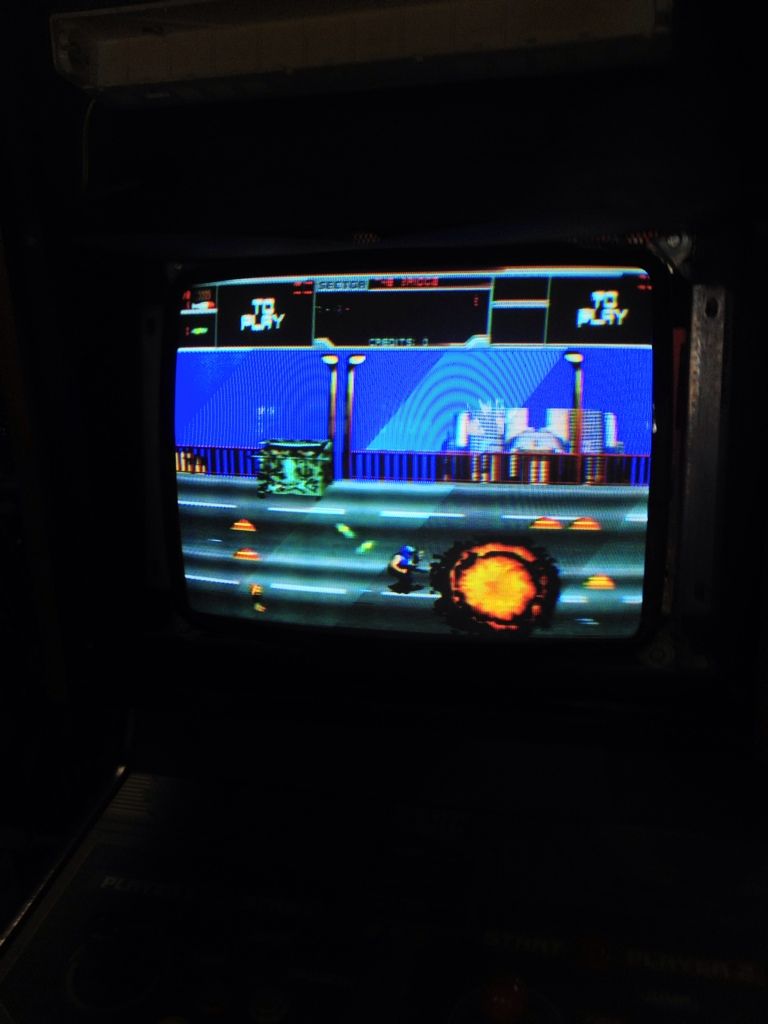

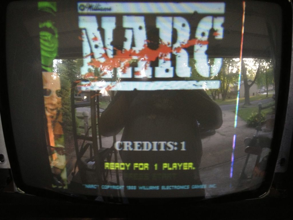

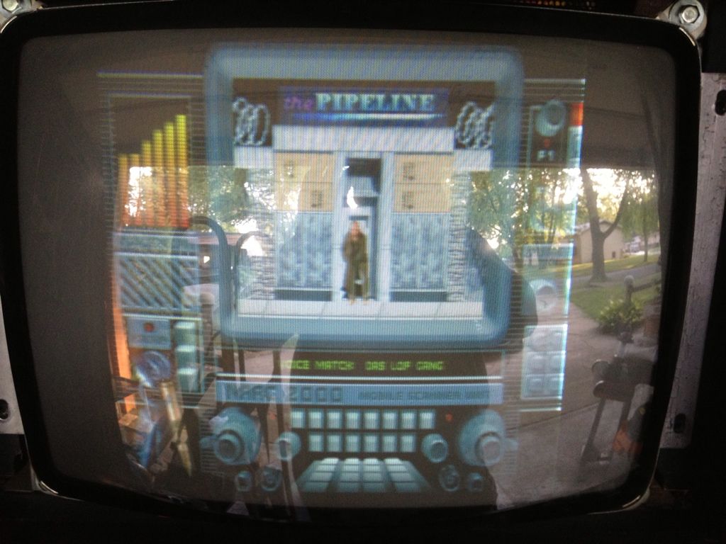

So after trying to disassemble another yolk and destroying it, I decided that unwinding is not for me. After a long discussion with VonGoosewink I decided to try to salvage the old yolk. Luckily the parts of the old yolk that broke were just enough to set the purity rings in place and with a little bit of fidgeting and a piece of 1'1/4" plastic drain pipe, some pressure and a clamp. I was able to get the yolk/rings in place.
Before convergence:
Great job, that's going to look great once fully converged! Glad you saved the monitor, those med-res are getting hard to find!
