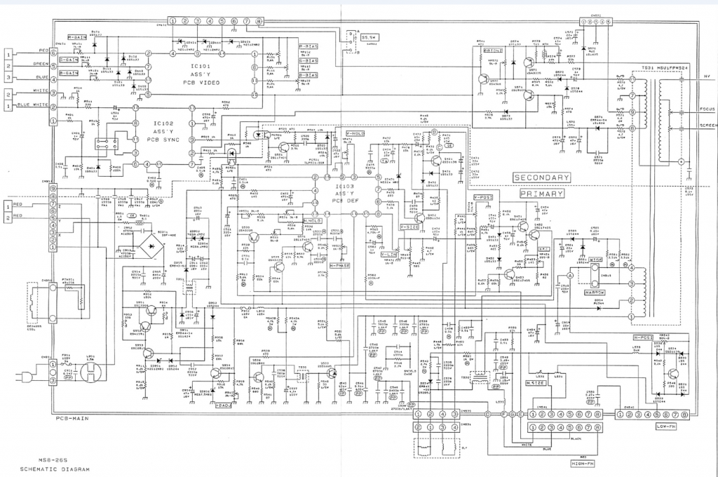

The schematics available online are terrible....
Not sure if they are the same as this, but this is the copy of the MS8-26S schematic that I have...
The actual file is a better copy than this pic, but it still isn't perfect, as it blurs as you zoom in. Someday I may vector it...
