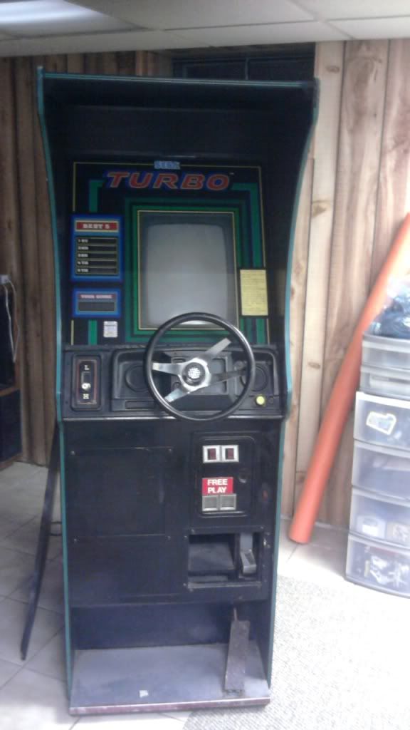

Hi all, I have a nanao monitor, and I believe the flyback is bad. The monitor is in my Sega Turbo upright, and it is the smaller monitor version one (14 inches, I believe). The chassis says KB240331B, which I believe is the MC-2000. Does anyone know where I could get a replacement flyback? Also, is there any way to test the tube to see if it is good (before fixing the chassis)? What tipped me off to the flyback was the popping noises and a smell similar to electric motor oil; do any other components smell like that? The monitor was horizontally collapsed, which was followed by a vertical collapse down to a blue spot around the size of a quarter. This slowly faded and shrunk, which is when I unplugged the game.
I have already replaced the HOT (shorted when I got the game) and the capacitors that were bulging. Any help would be greatly appreciated.

They made two variations of the upright. They are identical other than the monitor and bezel. I'm not sure if the difference matters, or if they have different caps, resistors and flybacks.
This one is the standard 19" monitor:
http://pinballstore.tripod.com/webonmediacontents/1528475.jpg?1328131282357
And this one is mine:
http://i1182.photobucket.com/albums/x444/Darth-Sonic/0227110206.jpg

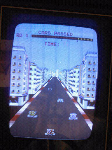

Sorry to revive an old thread, but I didn't want to withhold useful information. I got the monitor working. I used the chassis from the MC1400 (KB240331C) with the 16 inch tube (MC1600), and it worked! Also, I used the cap kit worm the MC2000 and all the electrolytic caps were the same value on the chassis for the 14 inch monitor. In the off chance anyone else has the same question, they are compatible.
Thank you to all who have contributed!
After the cap replacement and a bit of PCB work, this is what the game looks like. Note: the vertical bars are not visible in person.
