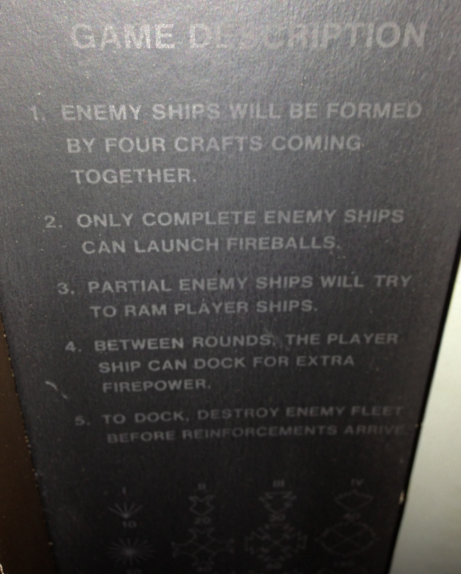

Can anyone identify the game this cardboard monitor bezel came from? Sure, I could Google it, but I think it would be more fun to see who knows it (without the help of Google et al). And no, I haven't already Googled it, because what's the fun in that?

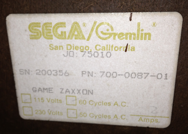

And not that it will help solve the puzzle, but just in case anyone is wondering, I purchased the cab as a conversion, in really rough shape. When I got it it had Sega Champion Baseball in it (which required some work to get going). But the cabinet was originally a Zaxxon (SN: 200356).
Sadly, the only evidence of this is the Sega/Gremlin sticker inside stating that, as you can see above. There were no Zaxxon boards, no Zaxxon harness, no Zaxxon marquee (actually, there was no marquee of any kind, come to think of it), and the monitor orientation has been switched to horizontal.

Space Fury
We have a winner! I was actually thinking that's what it was (only noticed it this afternoon as I was working around the cab). It looks like it was sort of painted over. It's really faint unless you look up close.

Today I finally got some time to start going through the cabinet more thoroughly, and I removed the power board. I hadn't gotten a close look at it until today, since access is pretty limited in the center section of the cab. Upon taking it out, it's kind of a weird hybrid of isolation transformer, switcher, and additional linear style power board. And all of these components were being used for the Champion Baseball boards that were in there.
And the weirder part is that the monitor is wired for 100v (verified that with a meter too). It's a 19" Nanao/Sega MC-2000-S chassis with a Mitsubishi tube. I thought only Nintendo cabs had 100v monitors?

I was talking about this in another thread ( http://forums.arcade-museum.com/showpost.php?p=2289906 ), but basically, according to the Zaxxon manual I found online, this make/model was indeed the original monitor. Confirmation of this also came when I took a really good look at the screen under fluorescent lighting. The Champion Baseball burn-in is obvious, but I can also definitely see Zaxxon burn-in, but it's not nearly as pronounced. So apparently this cabinet had Champion Baseball in it far longer than it had Zaxxon.
