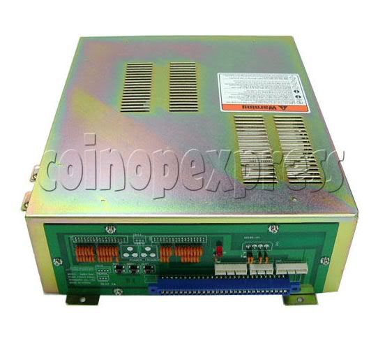

Looks like one of the versions of "Pump It Up!"
Here's a shot of another version:
It's Andamio Pump It Up.
Mk3, which is one of the old versions. Probably has disc & key for some version of "The Premiere" or "Prex" in it.
It needs external i/o boards & amps to function, and it's powered by an AT switcher through the 2 4-pin disk drive connectors, so you might be able to just apply power and hook up a VGA monitor to test it. Otherwise it's too much trouble to test outside of a cabinet.
